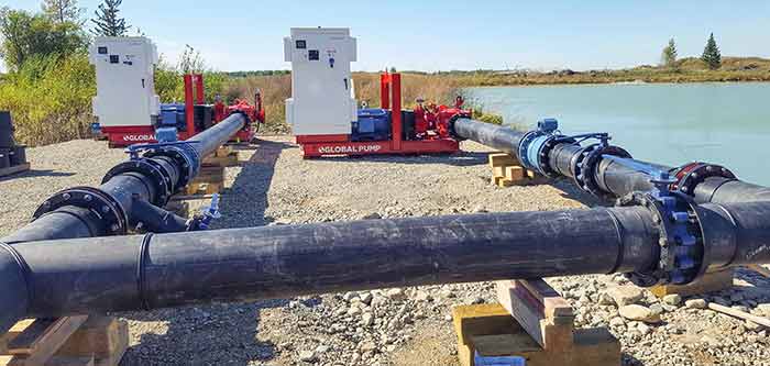

Image 1. Electrical pumping system set up for gravel pit/quarry dewatering (Images courtesy of Global Pump)
