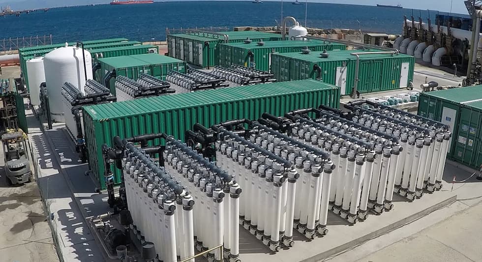

Containerized RO plant on the island of Sardinia. The plant supplies 12,000 m3 of ultrapure water and has cut energy consumption by 88%.

An infrastructure and renewable energy solutions provider opted for high-pressure RO pumps when tendering a new ultrapure seawater RO plant for a power company on the Italian island of Sardinia. The company had three main requirements for the new desalination plant: provide 12,000 cubic meters (m3) ultrapure water per day, cut the electricity consumption and carbon footprint, and complete the job quickly without any infrastructural modifications.
In six months, the new plant was up and running with four containerized RO units. One year into operation, the energy consumption of the desalination processes has been brought down by 88% compared to the old system.
