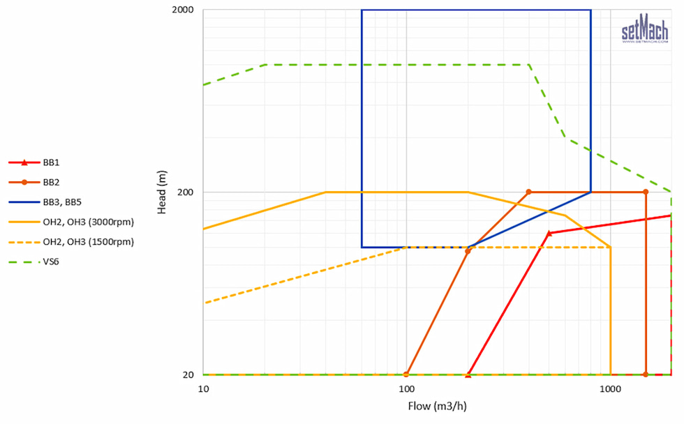

To ward off having to struggle with unreliable vertical process pumps, reliability-conscious users are encouraged to investigate (and aim for) pumps with the lowest life cycle cost. Attractive life cycle costs will steer reliability-focused best-in-class (BiC) users toward readily available and reliable vertical pumps. These pumps cover a wide range of heads (translatable to pressures) and flow rates (Image 1).
heinz image 1
IMAGE 1: The dotted green outline shows head/flow relationships for vertical pumps.2 (Images 1, 2, & 4 courtesy of the author)

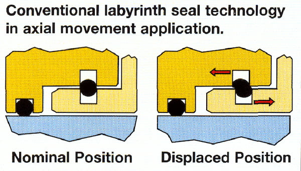

Protector seal with risky O-ring placement.
IMAGE 2: Protector seal with risky O-ring placement.
Some reliability professionals at BiC facilities use an experience-based rule-of-thumb multiplier. This multiplier simply states that a proven upgrade is likely to extend a pump’s uninterrupted run time capability by 20% or more.1  As just one of many examples, pumps with O-rings that risk being pinched during operation (Image 2) are thought to benefit from upgrading to products where this vulnerability does not exist (Image 3). The rule of thumb then assumes a 1.2-times run length extension for the first upgrade, and again a 1.2-times multiplier for the next upgrade.
