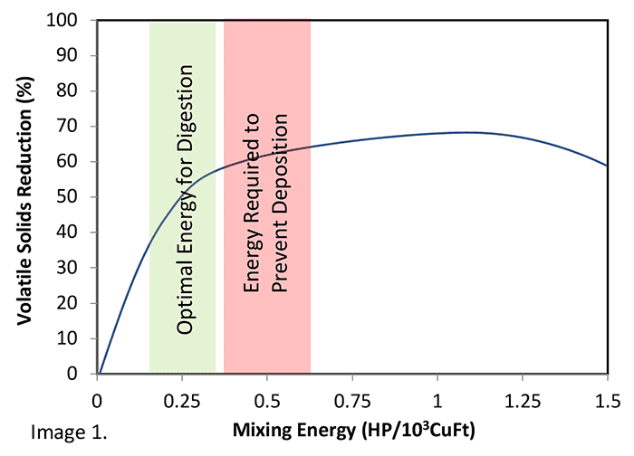

digester performanceImage 3. Typical relationship between mixing energy and digester performance

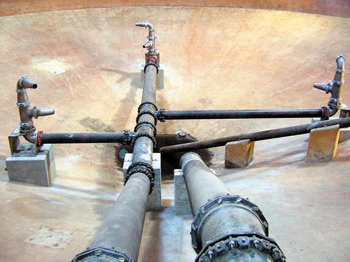

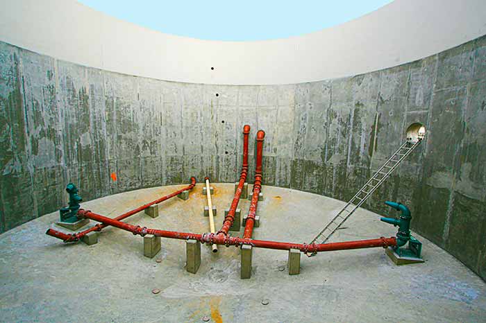

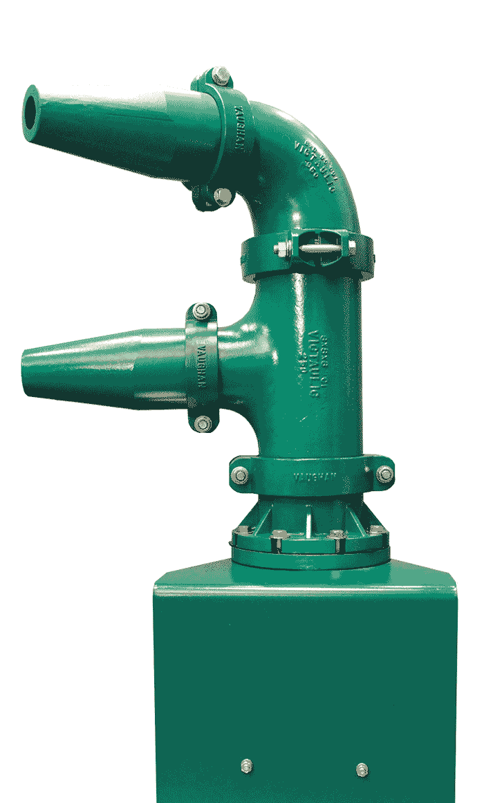

Hydraulic mixing systems are commonly used to provide mixing for CSTR anaerobic digesters. They consist of multiple nozzle assemblies within a tank, with flow often driven by a chopper pump. This produces an efficient, even distribution of mixing energy throughout the entire volume, while keeping moving parts out of the digester where maintenance can be more easily performed. For this example, consider a hydraulic mixing system, which centers on a chopper pump, and is designed to mix a typical 1 million gallon (MG) digester. For most hydraulic mixing systems, as flow to the nozzles is varied, the amount of energy transfer to the fluid also varies. Therefore, through manipulation of the operating curve of the chopper pump with a VFD, an operator can control the amount of mixing energy in their process.
Image 3 shows a typical relationship between mixing energy and digester performance. As mixing energy increases, digester performance also increases as temperature and pH become more consistent and inhibitory compounds are diluted. Eventually, the digester reaches a point where additional energy no longer improves performance and inefficiency occurs. At even higher mixing energies, overall performance may begin to decline due to mechanical foaming and sludge bulking. In most digesters, a mixing energy between 0.15 and 0.35 horsepower (hp)/103 cubic feet (CuFt) will provide the most efficient volatile solids reduction per unit mixing energy.

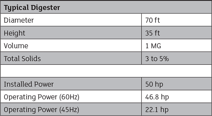

design parametersImage 4. Typical design parameters for a 1 million gallon digester mixing system

However, it is rarely necessary to continuously maintain the energy required to prevent deposition. In the example of this hydraulic mixing system, some applications may require as little as two hours per day at full mixing energy to allow for resuspension of settled solids. The remaining time can be spent operating at a lower mixing energy as required to maintain stable digestion. By varying the mixing energy in this way, a significant savings can be achieved. Typical design parameters for a 1 MG digester mixing system are provided in Image 4.
At full-speed operation of 60 hertz (Hz), the mixing system is operating at 46.8 hp. This will serve as the baseline energy consumption. If instead a VFD is used to operate at 45 Hz, the mixing system will now be operating at 19.8 hp. Assuming a daily operating schedule of two hours at
60 Hz and the remaining at 45 Hz, this brings the average operating power to 22.1 hp—a reduction of almost 53 percent. Assuming a power cost of $.08/kilowatt (kW), this produces an annual operational savings of $12,982 without reducing system performance. However, in some cases, more mixing energy may be required to maintain digester performance, which will reduce the possible savings. It is ultimately up to the operator to determine the ideal operating schedule for the facility and process.
hydraulic mixingImage 5. Example of a hydraulic mixing system
