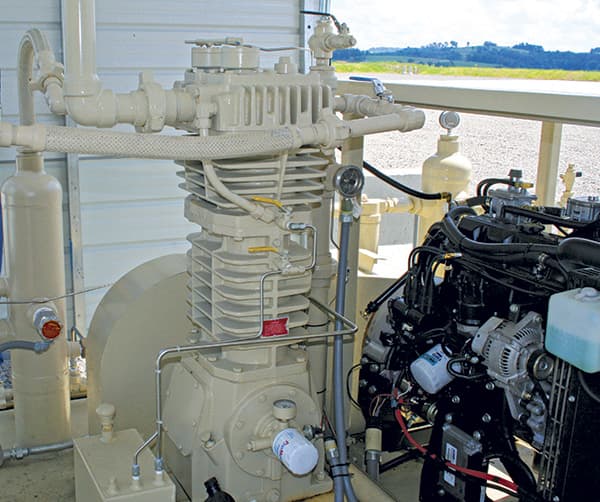

To optimize operational performance and production while reducing costly downtime and maintenance, the VRU base and skid assembly must be installed correctly.
- The compressor should be anchored to a baseplate (or skid) that is at least four times the compressor’s weight.
- The baseplate with the compressor and other VRU components should be bolted to a concrete slab or pad.
- The concrete slab or pad should be placed on a level surface.
- The pad should be prepared and graded, if necessary.
- The baseplate skid should never be installed on non-compacted soil.
