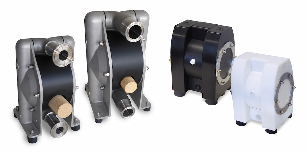

AODD pumps can be manufactured from a range of pump materials and possible combinations. The interior can be manufactured in a large number of elastomers and thermoplastics, from “black rubbers” such as neoprene or Buna-N (nitrile rubber) to polytetrafluoroethylene (PTFE). The pump’s housing can be manufactured in various metals, from cast iron and aluminum to high-grade stainless steels. The housing can also be manufactured in a variety of plastics, including high-performance plastics such as PTFE or polyether ether ketone (PEEK).
Therefore, depending on the mechanical/chemical properties or the temperature of the medium, the pump can almost always adapt to the application. And since the pump is constructed in a solid-block design, it provides additional design advantages when it comes to safety, including high stability and rigidity, static weight, and chemical-resistant surfaces.
