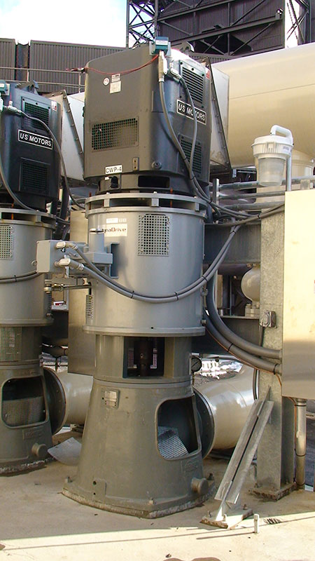

Rigid couplings
Most vertical turbine pumps (VTPs) have the rotor supported by the motor (no axial support in the pump bearings), so a rigid coupling is used between the motor shaft and the pump shaft (Image 1). For most VTPs, the shaft extension is properly called a line shaft, but “pump shaft” will be used here for simplicity. Misalignment between the two shafts is accommodated by flexure of the coupling components and the shafts themselves. While typical flexible couplings can accommodate significant misalignment, these rigid couplings cannot. Proper shaft alignment is critical for these machines.
