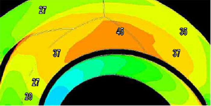

Number of Impeller Vanes x Rotational Speed—Vane Pass & Its Multiples
Pumped liquid progresses through the impeller and gains energy, and this energized liquid passes from the impeller to the volute or diffuser. There is an inherent variation of velocity across one impeller pitch (Image 4) and passing this on to the collector causes the vane pass vibration and its associated multiple. Using an analogy of a rotating saw tooth as a mental image helps to fix this concept in the mind.
Image 4: Computational fluid dynamics (CFD) illustration of absolute velocity change across one impeller blade pitch.
