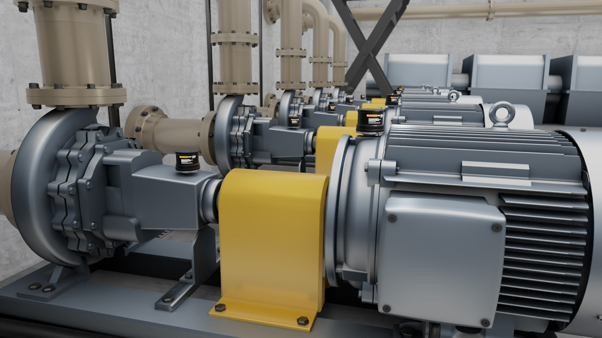

IMAGE 1: Changes in a machine’s vibration patterns are an indicator of potential problems. (Images courtesy of Fluke)

It is normal for machinery to vibrate, but excessive vibration prematurely causes wear in components and can shorten asset life. Changes in a machine’s vibration patterns are an indicator of potential problems. Monitoring vibration to screen for any changes helps teams identify imbalance, looseness, misalignment or bearing wear before failure occurs. Vibration sensors can monitor changes to the amplitude, frequency and pattern of vibration in motors and other machinery.
