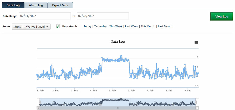

Monitoring system data log indicating a high flow rate

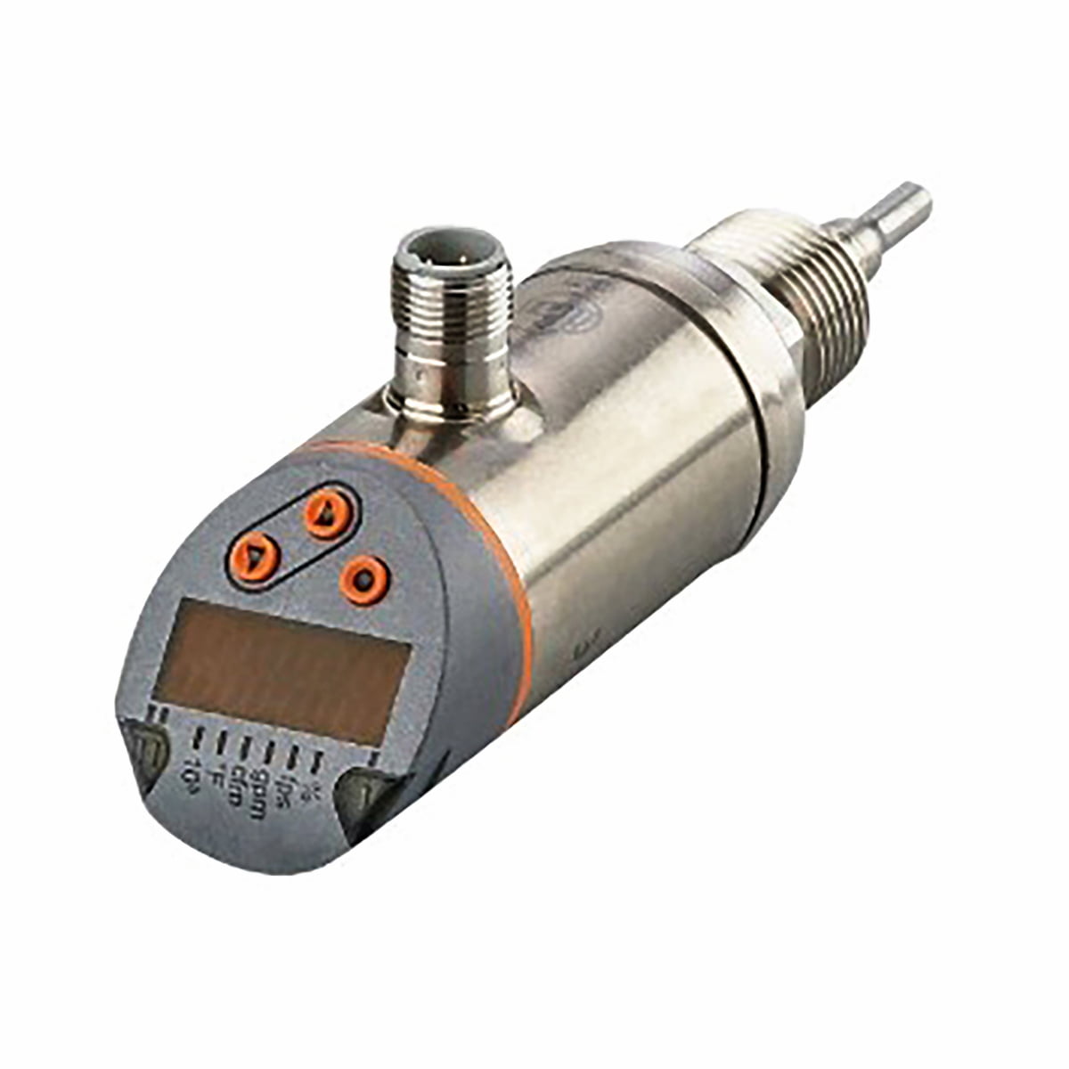

IMAGE 1: Thermal flow meter with digital display (Images courtesy of Sensaphone)

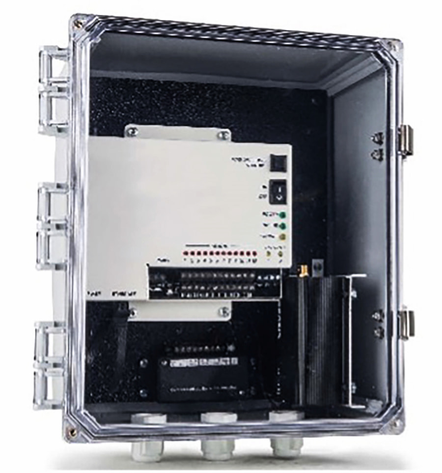

A monitoring system can be installed at both staffed facilities and unattended sites. It consists of a base unit that constantly collects data from sensors or existing equipment. The number of external sensors applied depends on how many inputs are on the base unit. Users program the device to designate the necessary high or low parameters on the monitored sensors. The base unit contacts designated personnel when a sensor reading moves out of the preset limits. Managers can receive these notifications via phone, email or text.
Users can also access real-time and historical data log information to look for trends that could suggest a problem and generate records to use in preparing regulatory reports. This information is helpful in determining if certain equipment and components are not performing at a satisfactory level.

IMAGE 2: Remote monitoring base unit in a  protective enclosure
