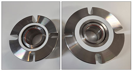

IMAGE 2: Standard and oversized bore cartridge seals for a 1.875-inch shaft with flat gaskets and slotted bolt holes
This device is typically a set of brass clips or an internal spacer. Clips must be removed after installation, while internal spacers remain in place during operation. The difference comes down to ease of installation—clips are more robust but add steps, whereas internal spacers simplify the process.

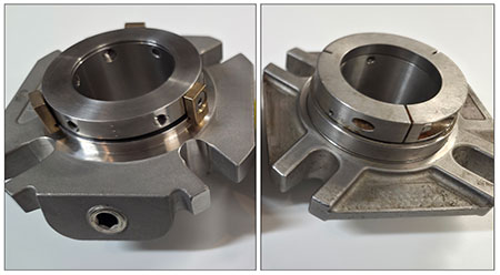

Shaft collar
The collar locks the seal securely to the shaft. This can be done with either a set screw or a clamp style collar.
Set screw collars, the most common type used on cartridge seals, have multiple set screws that bite into the shaft. Limited space can make tightening difficult, and the small screws can raise burrs or strip, causing removal issues or shaft damage.
IMAGE 3: Set screw and clamp style shaft collars
A friction drive collar makes seal installation and removal easier while improving seal alignment, though it may slightly reduce pressure limits compared to set screws.

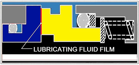

Seal faces are the heart of the seal. A rotating face and stationary face are seated against each other by spring force and hydraulic pressure to prevent leakage between them. Made from carbon graphite, silicon carbide or tungsten carbide, they are engineered to stay flat so a thin film of fluid can lubricate and cool them. Maintaining that flatness is the key to long seal life.
One face is spring-mounted to compensate for misalignment, shaft movement, vibration and bearing play.
IMAGE 4: Cartridge mechanical seal faces: rotary (blue), stationary (yellow) lubricating film (red) and springs to the far right

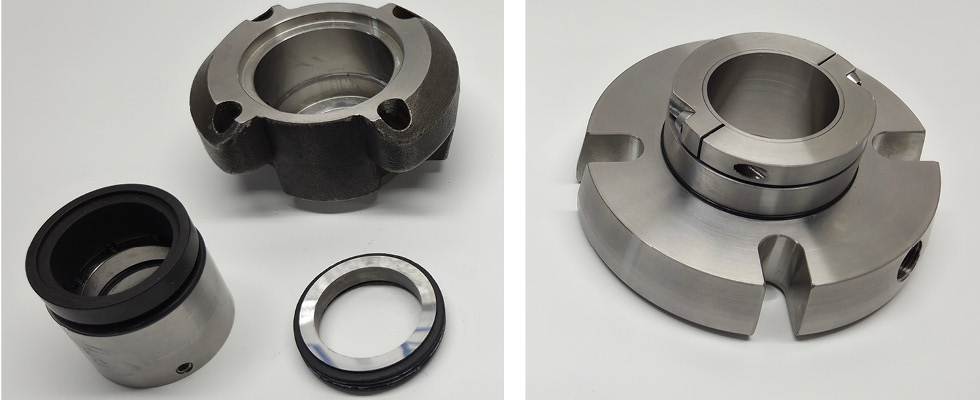

Much of a mechanical seal’s technology lies in the design of its faces. With limited space, fitting the seal face into a cartridge while achieving proper hydraulic balance and maintaining flatness is a challenge. Finite element analysis (FEA) helps evaluate how pressure and temperature affect face distortion based on geometry and material properties, revealing clear differences between two face types—composite and monolithic, with each reacting differently under the same conditions.
A composite face combines two materials—the sealing face and a metal holder. A monolithic face, by contrast, is made entirely from a single material.
The composite design uses heat to shrink-fit the face into a metal holder, saving space and reducing cost. It performs well in low-temperature, low-pressure and low-speed applications but can lose flatness under harsher conditions, causing leakage or seal failure.
IMAGE 5: Composite (shrink fit) and monolithic  seal faces
The design of monolithic faces is straightforward since they are made from a single material. FEA ensures that they stay flatter and more stable across a wide range of operating conditions.

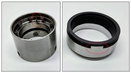

Another key feature is the drive mechanism. When the pump starts, each seal face must either rotate or remain stationary as intended. This is usually achieved with small drive pins.
Contact between the face and drive pin, combined with movement or vibration, causes wear on the spring-mounted face. This wear can lead to hang-up, resulting in leakage or seal failure.
IMAGE 6: Slot and pin wear
A heavier-duty drive, such as a lug drive, helps reduce wear—especially in frequent start/stop or high-vibration applications.

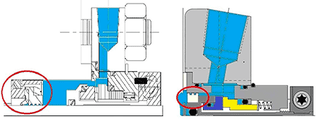

Pipe taps in the gland—referred to as environmental controls—are the final seal feature to consider. A seal may be designed with both flush and quench ports.
The flush port is on the process side of the seal and can be used in two ways. The first use is to circulate process fluid around the seal to cool or heat it, or to increase or reduce pressure for improved lubrication of the seal interface. The second is to flush the seal with an external fluid, providing improved lubrication and cooling.
IMAGE 8: Stuffing box mounted and seal mounted flush restrictor bushings
When using a flush, it is best practice to include a throat or containment bushing to control flow. The bushing maintains close clearance to manage pressure and minimizes the use of external fluids like clean water. A seal manufacturer can help determine the proper flow for an application. The bushing is typically installed directly in the stuffing box, though some seals incorporate the bushing within the seal itself.
