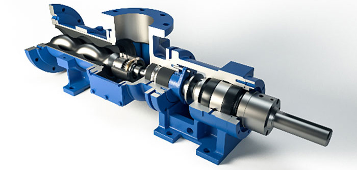

Image 1. PC pump cross-section (Images courtesy of NOV)- Align belts and sheaves. Belt-driven units can be both versatile and reliable, but improper setup and maintenance practices can lead to premature belt failure. Inaccurate or negligent configuration can also have a severe impact on the operating life of motors and driven components. Confirm the belt drive setup prior to startup, because these components may shift during the process of transportation or installation. When verifying setup, check that the sheaves are aligned within the pump’s tolerance.

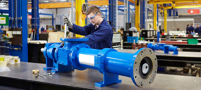

- Position coupling and belt guards. Because safety guards are often removed during the installation process, ensure that all safety guards are secured in their proper position. These guards provide protection in the risk of anything being caught in the fast-moving rotating shaft. If there are any concerns about the guarding, consult local safety codes or the equipment manufacturer.

Image 2. Position coupling and belt guards before starting.
Image 3. Check seals before starting a PC pump.Provide Pump Protection
