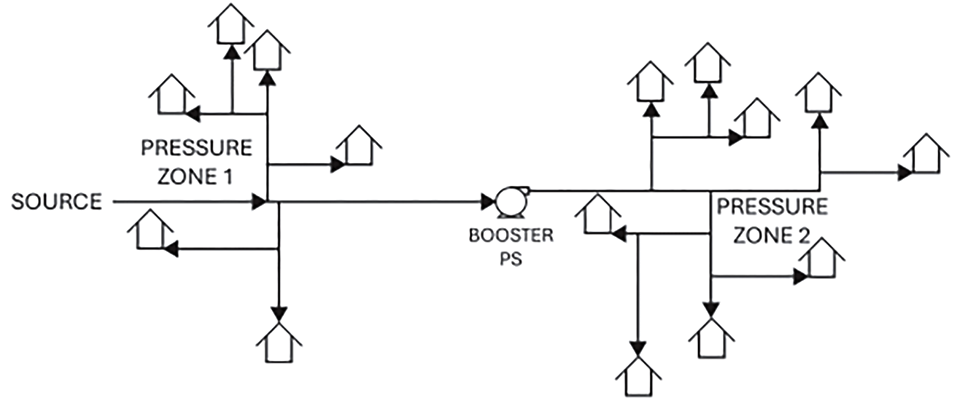

Water booster pump stations are placed in a distribution system that is fed by high-service pumps or gravity fed from an elevated tank. As illustrated in Image 1, the booster pump station serves the purpose of providing target pressure to one or multiple pressure zones in the distribution system that the high-service pumps or elevated gravity feed cannot support.
IMAGE 1: Illustration of booster pump station located between pressure zone 1 and 2 so that pressure zone 2 has sufficient supply pressure (Images courtesy of the Hydraulic Institute)
IMAGE 1: Illustration of booster pump station located between pressure zone 1 and 2 so that pressure zone 2 has sufficient supply pressure (Image courtesy of the Hydraulic Institute)
