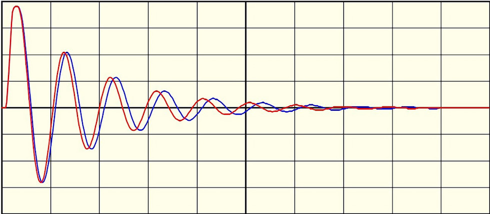

IMAGE 3: If the motor loses a turn because of an arc or short, the frequency of the waveform increases causing it to appear to shift left. In this failed pulse-to-pulse test, the blue wave is from the pulse before the arc and the red wave from the pulse that arced.
This test can find cases of weak insulation before the motor progresses to complete failure.

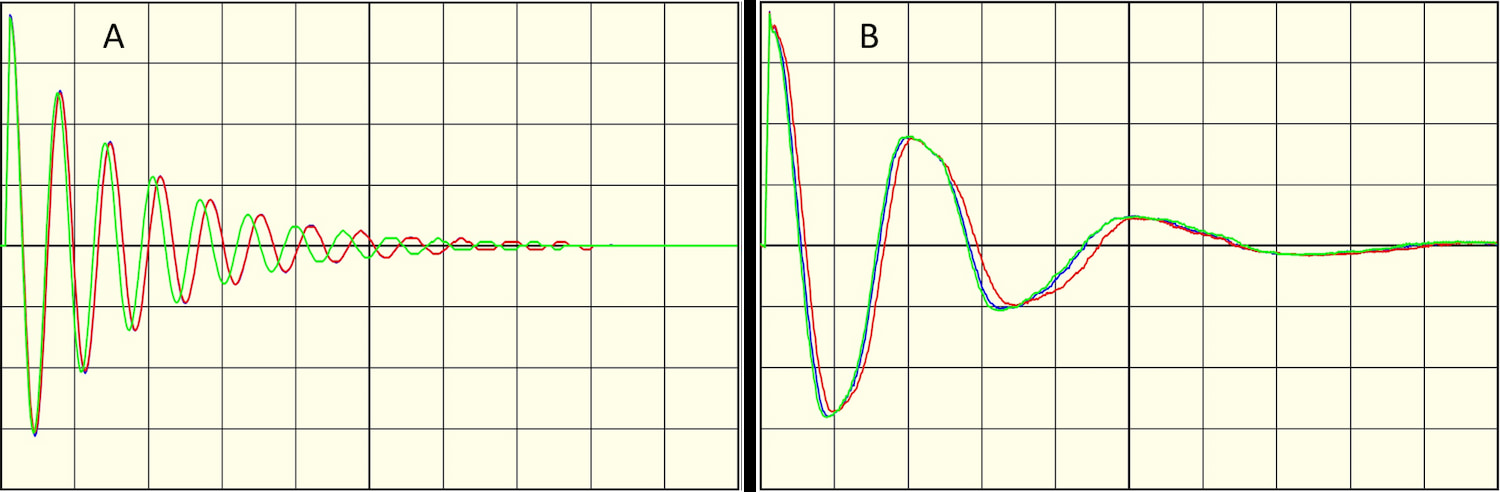

IMAGE 1: A winding with fewer turns will produce a higher frequency waveform (A) than a winding with more turns (B). An assembled motor will typically have a lower wave frequency and be more dampened than the motor stator alone. (Images courtesy of Electrom)

A high rise-time pulse is repeatedly sent through the winding by circuitry in the test instrument. The result is a decaying oscillating wave for each pulse, displayed on a screen by an oscilloscope circuit. The number of oscillations of the wave depends on the Q factor of the motor (impedance components)—how much the surge wave is dampened by the motor winding circuit. The rotor and the construction of the motor determine the level of dampening. The frequency of the waveform is inversely proportional to the number of turns. Therefore, a winding with fewer turns will produce a higher frequency wave and vice versa, with everything else being equal.
The surge tester increases the voltage of each pulse and compares the resulting surge waves by calculating a percent wave difference. If the motor loses a turn because of an arc or short, the frequency of the waveform increases. On the test screen, this appears as if the wave suddenly shifts to the left. When this happens, the difference between waves increases. The difference is calculated by the tester as a percentage.
Surge waves are compared in two ways: phase-to-phase and pulse-to-pulse. A phase-to-phase comparison in a three-phase motor compares phase 1 to 2, then 2 to 3 and then 3 to 1. In a pulse-to-pulse comparison, each phase is tested against itself. As the surge voltage is gradually increased, the surge tester compares each new waveform to the previous one.

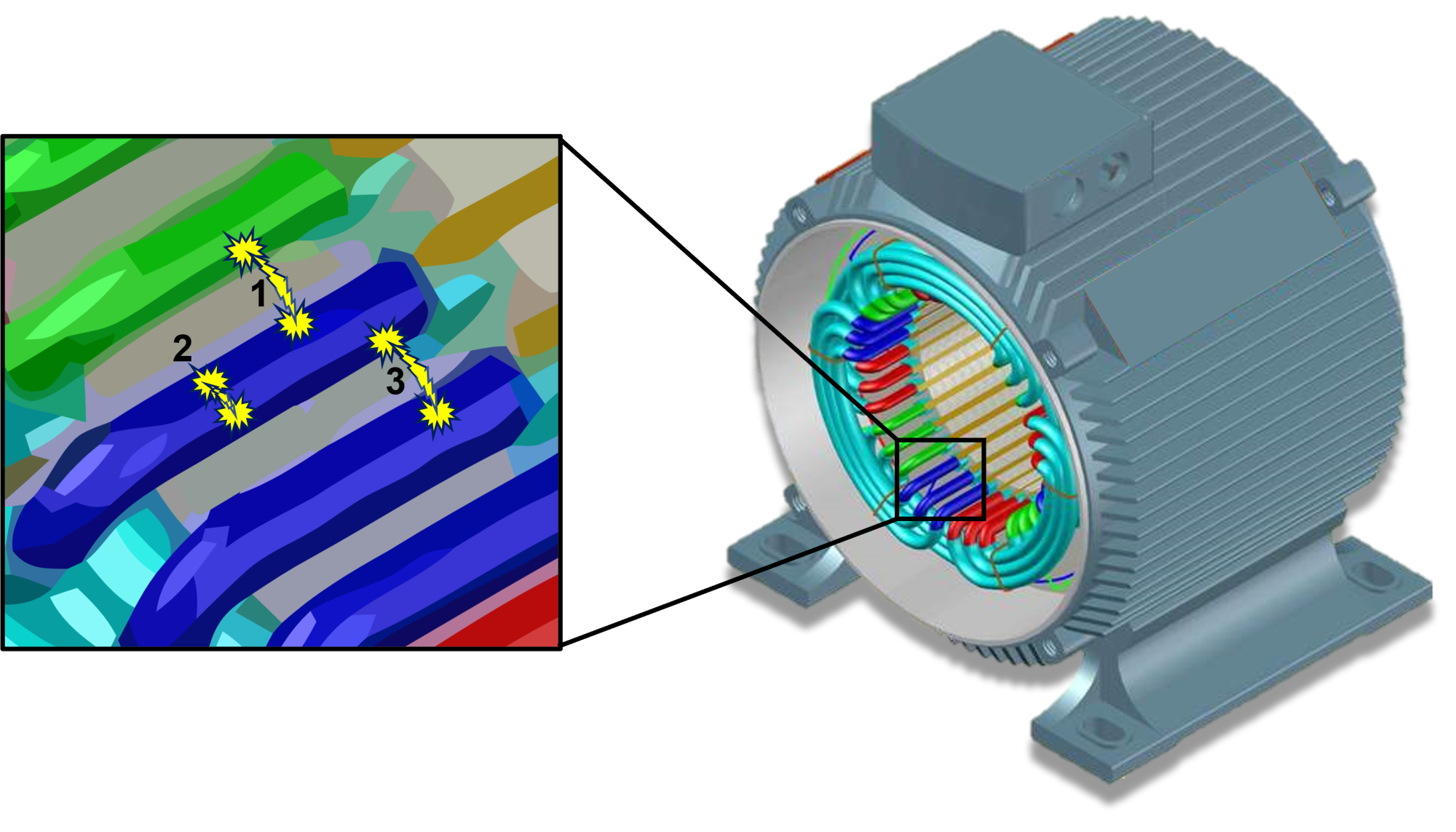

IMAGE 2: Each motor phase is highlighted with a different color winding. The surge test can find phase-to-phase (1), turn-to-turn (2), coil-to-coil (3) weaknesses and shorts.

  • phase-to-phase weaknesses and shorts (1)
  • turn-to-turn weaknesses and shorts (2)
  • coil-to-coil weaknesses and shorts (3)
Not pictured in Image 2:
  • wrong turn count
  • wrong coil connections internally
  • weaknesses to ground (in some cases only and not as well as a hipot test)
