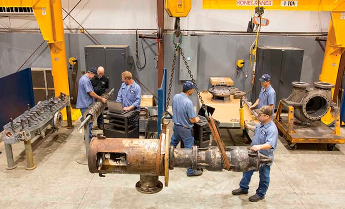

Image 1. Pump repair is available for all API designations.Image 1. Pump repair is available for all API designations. (Images and graphics courtesy of Standard Alloys Inc.)
