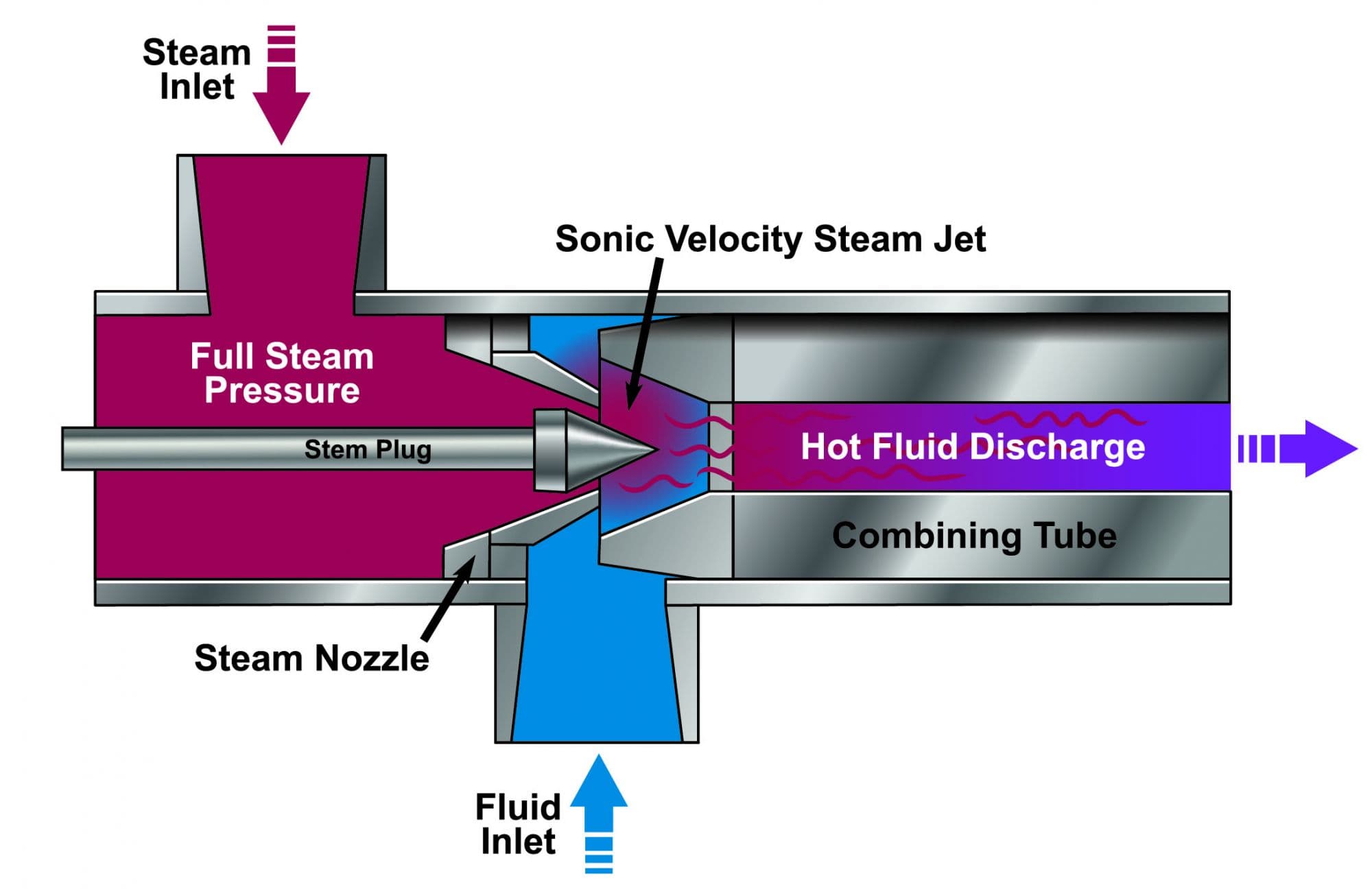

Internally Modulated Sonic Velocity Steam Injection
DSI heaters designed to internally modulate the mass flow rate of steam at the injection point use the principle of choked flow. A nozzle or a diffuser is generally used to modulate the steam flow and inject it at sonic velocity.
Internal modulation diagram
Image 2: Internal modulation diagram (Images courtesy of Hydro-Thermal)
Choked flow can be defined as a fluid dynamic condition. A compressible fluid at a given pressure and temperature passes through a restriction (nozzle or a vena contracta) into a lower pressure region by increasing velocity. The increase in velocity occurs with the mass flow being unchanged, following conservation of mass. Therefore, the generation of choked flow can be identified as the operating point at which the ratio of the downstream pressure to the upstream pressure falls below the critical pressure ratio limit. Also, while the choked flow condition is achieved, a change in the downstream pressure will not affect the flow velocity as long as the pressure ratio is within the recommended critical pressure ratio limit.
As for DSI, a sonic velocity for steam injection can be achieved across a flow restriction such as a nozzle or an orifice when the absolute pressure ratio between the process pressure (liquid) and the steam pressure is below 0.575—i.e., downstream absolute pressure is 57.5% of the upstream absolute pressure.
Using sonic velocity for steam injection uniformly disperses the steam into the process liquid, thereby achieving a consistent temperature profile. In addition, natural turbulence is introduced within the controlled volume. Due to the sonic velocity, the steam jet also requires mixing velocity to condense the steam vapor into the liquid instantaneously. This rapid condensation of the steam helps eliminate problems such as two-phase flow and the formation of bubbles. Internally modulated DSI heaters thus achieve complete condensation of steam and uniform dissipation of the energy before the liquid exits the discharge of the heater.
An internal modulation heater can be installed inline or around a tank to prevent the possibility of having live uncondensed steam within the given system. As mentioned earlier, the use of a single nozzle in these heaters focuses the incoming steam and accelerates it to a high velocity before contacting the process fluid. This high velocity helps to atomize the steam bubbles and shear the incoming process fluid, which allows for a more complete, efficient heat transfer. The result is no steam hammer, precise/uniform heating and reduced maintenance.
