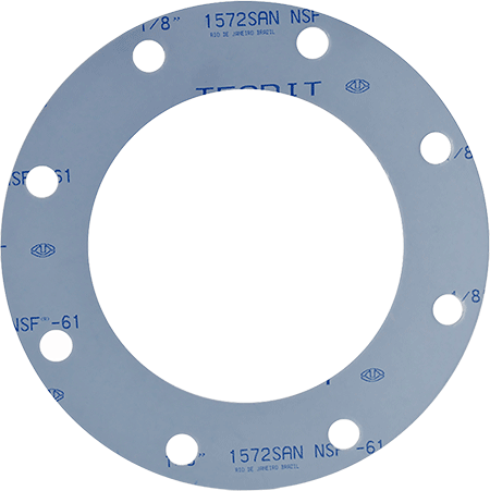

IMAGE 1: An example of a reinforced PTFE gasket specifically formulated to allow compliance for drinking water system components with NSF-61. (Image courtesy of TEADIT)

Selecting the right sealing material for potable water service requires balancing mechanical performance with chemical safety. Materials must seal effectively under load while providing long-term resistance to leaching, degradation and creep relaxation. Common material classes include elastomers such as ethylene propylene diene monomer (EPDM) and nitrile, compressed fiber sheets and fluoropolymers such as polytetrafluoroethylene (PTFE). PTFE-based materials are often preferred for critical potable water applications due to their chemical inertness, low extractables and broad temperature tolerance.
Restructured PTFE: Engineered for Performance & Compliance
While PTFE is widely recognized for its chemical inertness and low extractables, traditional skived or molded PTFE materials present challenges in sealing performance. Creep relaxation can compromise long-term sealing reliability by decreasing the amount of gasket stress applied to the gasket.
To address this, restructured PTFE materials have been developed to provide additional benefits over conventional PTFE. Filled with glass microspheres, the engineered material allows the gasket to:
Compress and effectively conform to irregular flange surfaces
Resist gasket creep and cold flow
Maintain gasket stress over extended service intervals
Preserve chemical inertness and low extractable characteristics
