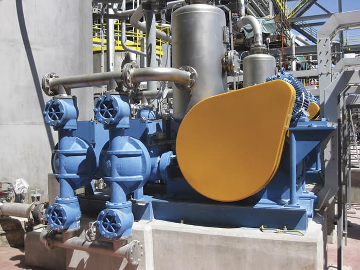

Mining slurries tend to be abrasive with solid specific gravities of 2.65 or more and slurry specific gravities of 1.65 or greater at solids concentrations as high as 70 percent. Abrasive wear varies with velocity. End users should consider the effects of abrasive wear during pump selection. PD pumps operate at relatively slow speeds and are effective in transporting mineral slurries. This industry utilizes the progressive cavity and rotary lobe designs found in PD pumps; however, the slurry’s path travels through tight places, such as rotors and stators or lobes. These designs are unfavorable to abrasive wear in intense applications and should never be run dry. One of the best pump options for this duty are piston diaphragm designs that can run dry and are highly abrasive-resilient. Slurry does not pass through tight constrictions. Instead, elastomer diaphragms are used, and they are relatively passive in displacing the slurry. As a result, the diaphragm’s fatigue limit—not so much the abrasion—determines the diaphragm life..jpg)
