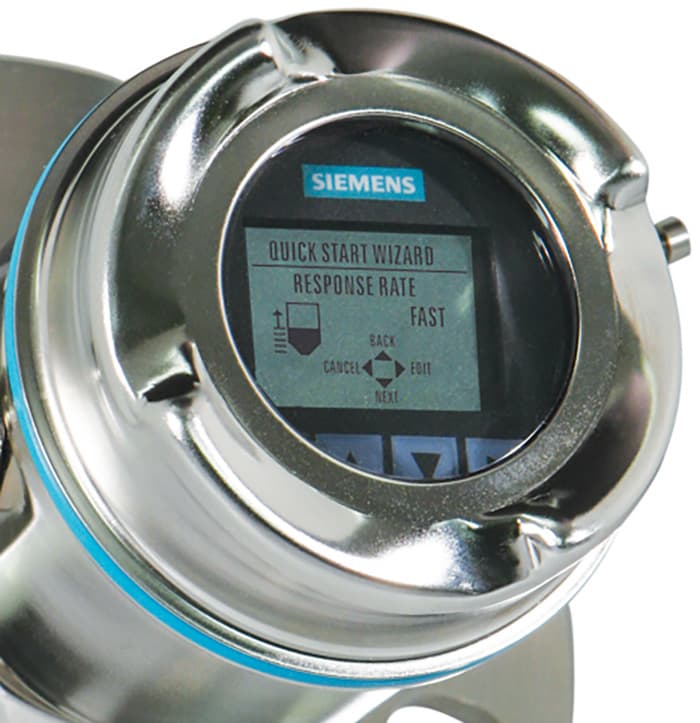

Image 3. User friendly interfaces help get operators up and running in minutes.4. Taking the Uncertainty Out of Pump Control
