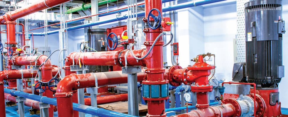

IMAGE 1: Fire pump motor (Images courtesy of Nidec Motor Corporation)
