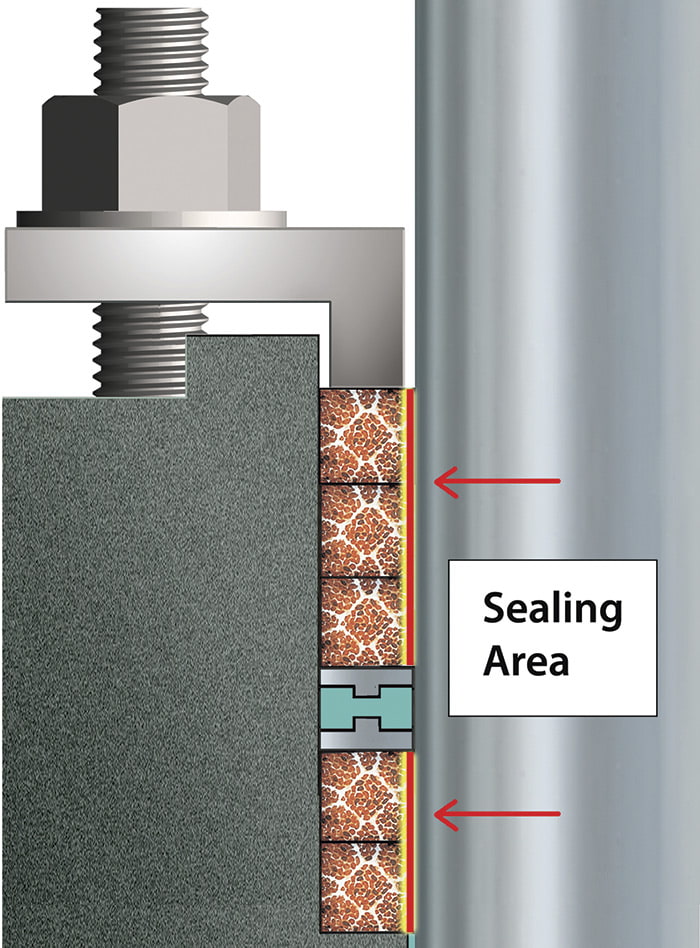

Legacy Sealing
Compression packing has been used for more than 100 years. At the turn of the 20th century, it was the best available technology. Most pumping devices were designed to use compression packing to seal the pump shaft and incorporate a stuffing box to contain the multiple rings of packing used to seal the shaft. When this technology is used, cut packing rings are installed around the shaft and pressed into the stuffing box. A packing gland is tightened, compressing the material axially and radially, while creating a dynamic seal between the pump shaft and the packing. End users must be careful to avoid overtightening the packing gland, which can cause the packing to overheat as a result of excess friction between the packing material and pump shaft. Flush water lubricates and cools this sealing interface while keeping solid contaminates away from the stuffing box area. When materials such as wastewater are pumped, solids tend to embed in the softer packing material, accelerating the wear of the pump shaft. A clean and reliable flush source will help enhance and improve the reliability of the packing. Any interruption of clean flush water to the compression packing will cause the packing to overheat, accelerating both packing and shaft wear, increasing seal leakage and necessitating maintenance intervention. Compression packing is usually the sealing solution that original equipment manufacturers (OEMs) use to seal equipment. It is a versatile option that does not require dismantling the pump or equipment during installation. This is especially important for larger pumps, which require special handling equipment to lift and move. The downtime required to move and restore large pumping equipment is a significant concern. In critical applications, such as influent or effluent pumping where larger pumps are used to move wastewater streams, downtime can be detrimental, especially in the face of uncertain weather conditions and additional flows into the treatment plant. While compression packing is a flexible sealing device, it requires maintenance for break-in periods and for adjustments to reduce leakage to an acceptable rate. Packing also requires some leakage to operate long-term. This leakage can cause secondary issues such as premature bearing failure and collateral equipment damage that will lead to unscheduled equipment downtime. Wastewater leakage is a biohazard that is a safety issue in any facility. Packing also wears the dynamic sealing area where it seals against the sleeve or shaft of the pump. These occurrences will affect the run life of the pump and lead to costly downtime for sleeve, bearing and component replacement..jpg)

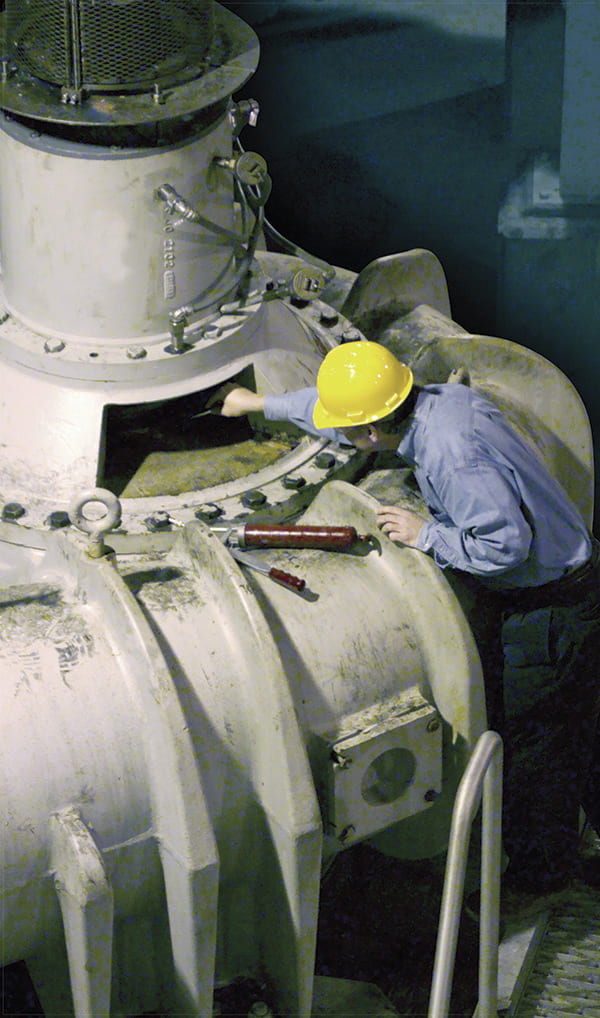

Mechanical Seals
Another option for sealing pumps and other types of rotating equipment is axial mechanical seals. Unlike compression packing in which dynamic sealing occurs radially between the packing and the pump shaft or sleeve, a mechanical seal typically seals axially between two seal faces, eliminating much of the shaft wear caused by packing. Mechanical seals are designed to seal leak-free, enhancing sealing reliability and minimizing pump damage caused by leakage. Eliminating leakage during pump operation will reduce the risk of bearing contamination and premature failure. Collateral equipment damage also can be eliminated, which will further increase sealing reliability and reduce operating costs. Split mechanical seals, where seal components are radially split, have been commercially viable for more than 30 years and have gained wide acceptance in various process industries. Split mechanical seals established a radical shift in the mindset of process engineers, allowing a pump to be sealed with a mechanical seal while eliminating the protracted process of disassembling the pump.
Technology Advancements
One major material advancement used in mechanical split seals is silicon carbide for the sealing elements or faces. Silicon carbide has excellent heat dissipation properties, which is important because seal faces rotate against each other and generate heat. The higher the operating speed and the larger pump the shaft diameter, the greater the heat generation that will occur between the mating seal faces. The development of larger silicon carbide seal faces and technology to split larger faces has enabled the use of silicon carbide and other seal face materials in larger-diameter split seal designs. Silicon carbide is an extremely hard material, ranking 9 to 9.5 on the Mohr hardness scale (diamond is 10). The abrasion-resistant nature of silicon carbide will help mitigate the adverse effects that solid contamination has on the sealing elements.
