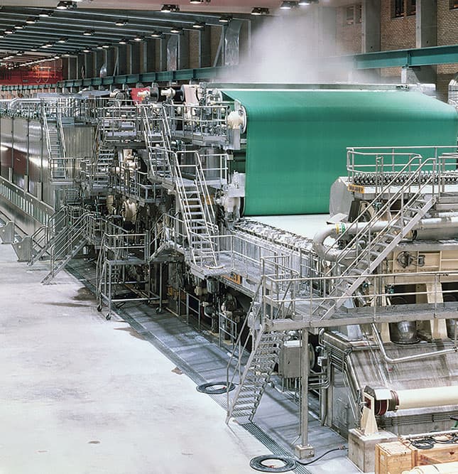

Bearings play vital roles in promoting efficiency and reliability of pumps and machinery for papermaking with some larger paper machines incorporating as many as 1,500 bearingsImage 1. Bearings play vital roles in promoting efficiency and reliability of pumps and machinery for papermaking with some larger paper machines incorporating as many as 1,500 bearings. (Images courtesy of SKF)
Larger paper machines, for example, can incorporate as many as 1,500 bearings. Regardless of their number, location and particular function in an application, the reliability and service life of bearings are inextricably linked to maintenance and operating conditions. Several conditions can result in premature bearing failure, including excessive sliding of surfaces (causing abrasive wear), improper loading combined with inadequate lubrication (leading to a severe type of wear called smearing) or the ingress of water (causing corrosion/tatic etching).
