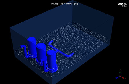

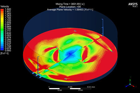

CFD examplesvelocity contours
vector plots
IMAGES 4-6:  Examples of CFD—velocity contours and vector plots.

Computational fluid dynamics (CFD) is a key tool for validating hydraulic mixing system designs. It is used to customize the system to the user’s application requirements. Commercial CFD software can develop a meshed 3D model of a tank integrated with a hydraulic mixing system.
CFD simulation
IMAGE 7: CFD simulation images displaying velocity contours, streamlines and vectors tank.
Fluid properties and simulation parameters are defined. The software uses this information to create a simulation of the proposed mixing regime. Velocity contours, velocity vectors, particle streamlines and iso-surfaces can be plotted onto the simulation. These tools are used to analyze the mixing regime and validate its effectiveness or whether further adjustments are required to ensure a proper mix. The simulation aids users in validating and understanding how the hydraulic mixing system will operate and whether it will meet their performance goals before the system is set up at the project site.
