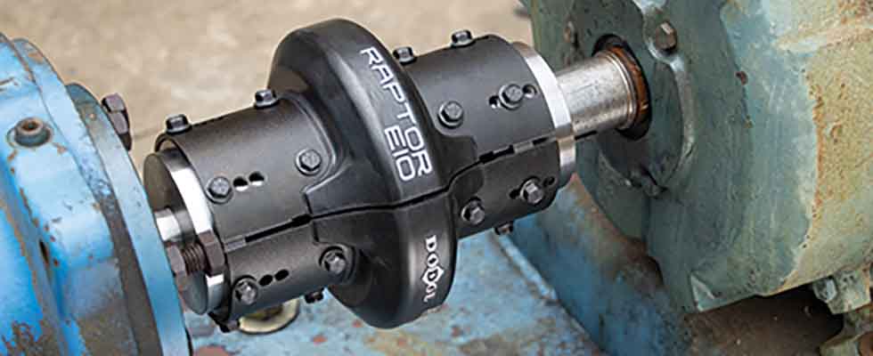

elastomeric coupling on motor

Best practice is still laser alignment at installation; however, thermal growth, pipe strain and baseplate settling increase the likelihood that some misalignment will occur over time. When shafts are offset, the coupling’s bending stiffness converts angular error into a reaction force that is transmitted straight into the nearest bearings. Laboratory tests on tire-style couplings show that a polyurethane element can generate, on average, 2.55x the reaction force of a geometrically similar natural-rubber element under the same 4 degrees of angular deflection. The extra load multiplies at the bearing centerline, accelerating the fatigue of either the pump or motor bearings.
An example from a 5-horsepower (hp) centrifugal pump that is coupled to a motor with a split-tire style coupling illustrates the point. With 4 degrees of misalignment, the inboard pump bearing sees its reactionary load increase by 1.52x when a soft natural-rubber coupling is used and 3.88x when using a stiffer polyurethane version of the same coupling style. L10 bearing life calculations predict roughly a 16-fold bearing life advantage for the softer element under those conditions. The message is not “skip alignment” but rather that the elastomer is the last line of defense when the real-world shifts machinery out of specification.

  5. Plan for maintenance access: Radially split tire-style couplings allow for removal without moving hubs, minimizing mean-time-to-repair and preserving shaft alignment.
