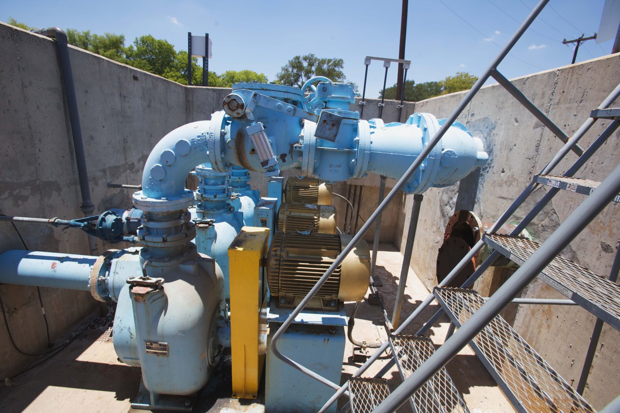

Replacing standard motors with NEMA Super Premium efficiency (IE4) models or combining motors with variable speed drives reduces energy losses and enables measurable cost savings.
IMAGE 1: Replacing standard motors with NEMA Super Premium efficiency (IE4) models or combining motors with variable speed drives reduces energy losses and enables measurable cost savings. (Images courtesy of ABB)

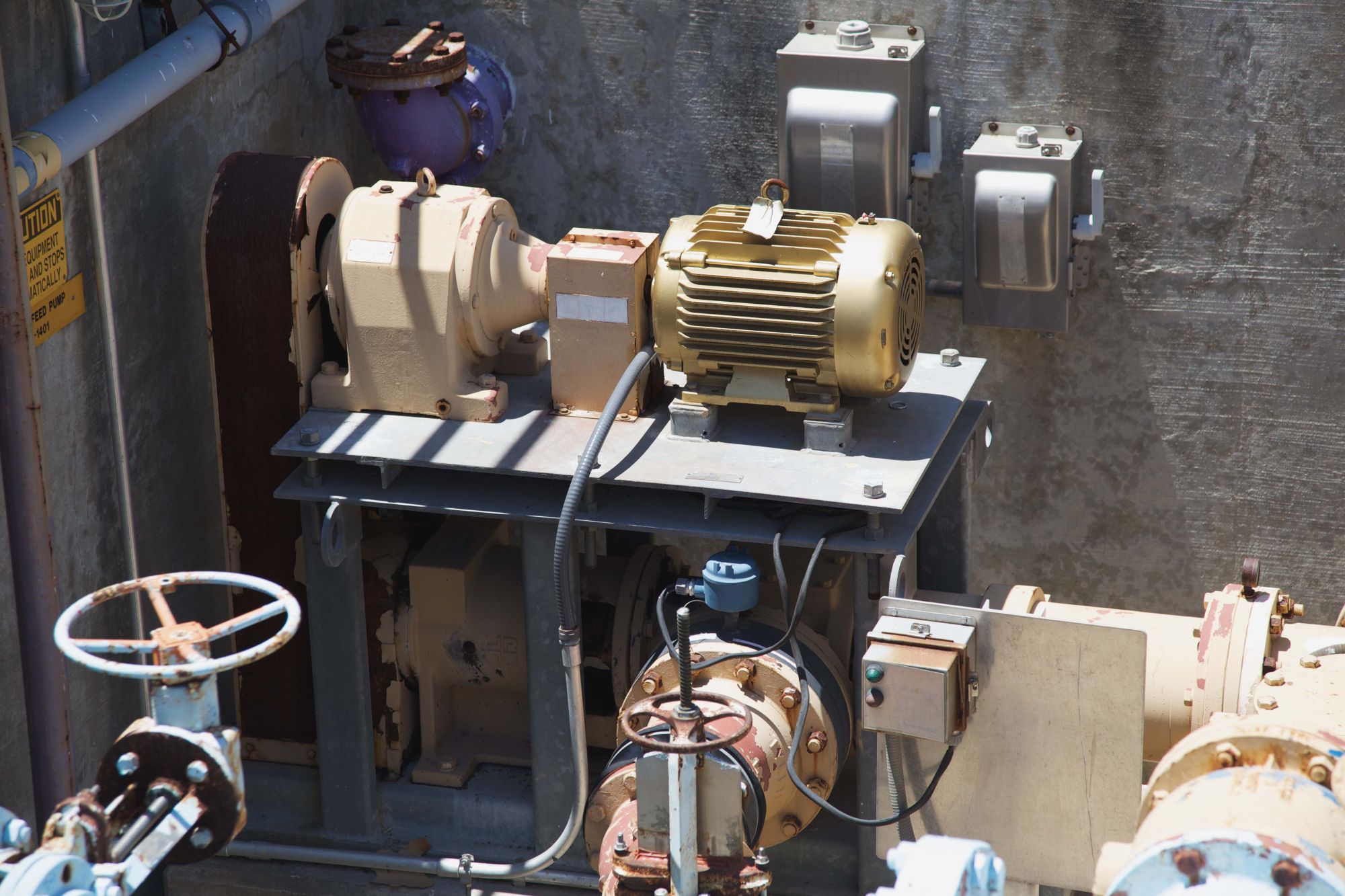

High-efficiency motors can differ in size and weight from older models, making it essential for engineers to account for form, fit and function during replacement.
IMAGE 2: High-efficiency motors can differ in size and weight from older models, making it essential for engineers to account for form, fit and function during replacement.

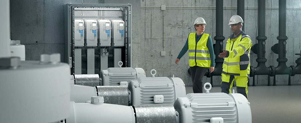

An optimized pump system reduces energy waste, lowers maintenance costs and minimizes downtime, with a motor upgrade as the first step.
IMAGE 3: An optimized pump system reduces energy waste, lowers maintenance costs and minimizes downtime, with a motor upgrade as the first step.
