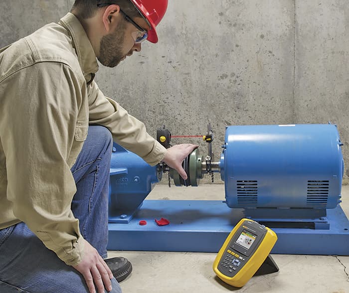

Industrial rotary pumps are designed for smooth operation. In their ideal state, they would operate with almost zero vibration. The flexible couplings often used to connect pumps to motor drive shafts are prone to misalignment. Many argue that flexible couplings are able to accept some misalignment. However, the problem is that the forces are still present and can still be transferred to the seals and bearings, causing them to wear more rapidly and fail much sooner. In addition, the forces from misalignment generate vibration and heat, which can lead to premature bearing wear in both the pump and the motor. Ultimately, this can cause equipment failure. Other troublesome issues in motors include soft foot—where the motor foot is off kilter—as well as electrical issues such as harmonic distortion coming from a motor or variable frequency drive. Best practices in motor maintenance affecting pumps include vibration testing to diagnose problems and laser shaft alignment to ensure proper operation. Additionally, power analyzers can help diagnose problems related to harmonics and other variants that can damage rotating equipment.Permitting & Paperwork
