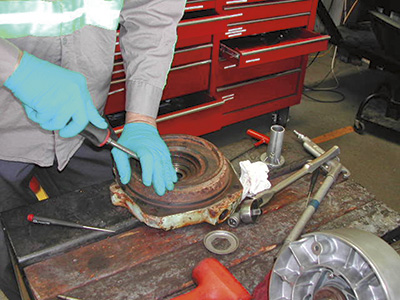

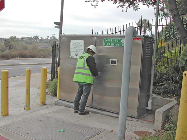

To meet the expedited 90-day schedule mandated by the contract terms, the California office of the wastewater pump manufacturer supplemented its local field with help from its sister office. Each pump station then underwent a one- or two-day thorough inspection after pulling each pump and examining controls, electronics, volutes, impellers and other components.
Although the wastewater pump manufacturer service trucks rival a “repair and parts shop on wheels,” it can provide a temporary bypass pump as a backup when repairs require the resources at the service shop.
The field technicians adhered to a 20-point checklist that disclosed deficiencies attributed to possible past oversights. The procedure used thermal imaging evaluations, along with hands-on techniques that revealed extensive ragging in the check valves and volutes, worn bearings, seals and O-rings, loose wiring, and an improper lubricant in the pump sleeves. The improper lubricant could have shortened the life of the pumps.
The two-man inspection teams also discovered motors close to failure and a few wetwells that lacked a backup pump. If a pump failed at these stations, the absence of a reserve pump could have set the stage for a spill.
The deficiencies were compiled into itemized reports on a station-by-station basis noting priority conditions recommended for action. The extent of the problems at many locations was unusual because some of the pumps were fairly new.
