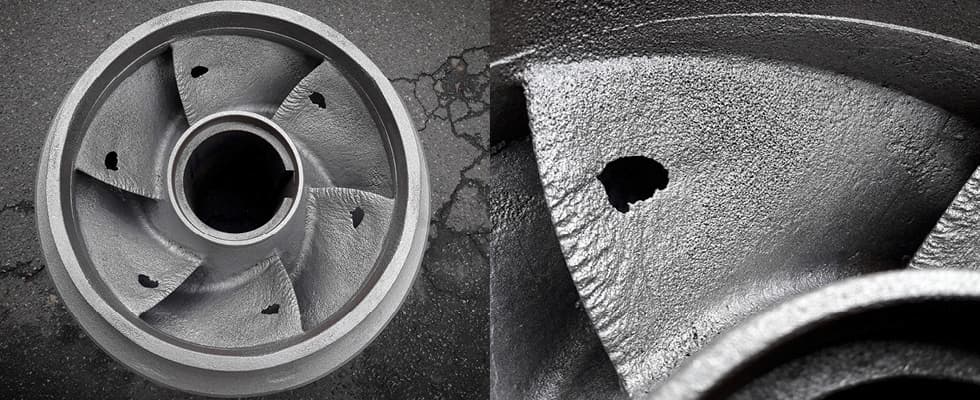

IMAGES 1&2: Pitting that results from the shockwaves generated by the vapor bubbles imploding can even put holes in the pump blades. (Images courtesy of ABB)

Cavitation comes from vapor bubbles collapsing inside a liquid, sending shockwaves throughout the liquid. The vapor bubbles are created when there is a local pressure drop below the vapor pressure. This can happen inside the pump or in the pipes and valves containing the liquid. In fact, any obstruction that can create a local low-pressure zone can lead to the creation of vapor bubbles.
The collapse of a vapor bubble is like a small, rapid explosion where a great deal of energy is released locally, creating damage. The implosion of the bubble leads to surface erosion when the shockwaves hit the impeller blades or the pump housing. This results in tremendous noise and noticeable vibrations. These common symptoms of cavitation are often some of the first signs of an issue.

Cavitation can negatively impact pump operation and lifespan. The creation of vapor bubbles may not be a problem, but a problem can occur when the bubbles in the liquid move in the pipe or pump and enter an area with normal pressure, typically only a short distance from where they were created. In the normal pressure area, the bubbles then implode, sending shockwaves into the liquid. The shockwaves can cause such severe pitting that they can ruin the impeller blades or the pump housing, as seen in Images 1 and 2. But even before that, the efficiency of the pump begins
