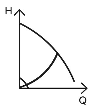

For example, a fixed speed pump will always run at the same speed, and the actual load point of the pump will be where the system curve intersects with the pump performance curve (flow vs. head). This leads to changes in head, depending on the actual flow. In most cases, this variation of head is unwanted. However, using a VFD to control the pump leads to a more constant performance of the whole system. The VFD allows the pump to work only at the speed required to meet the current demand, rather than at full speed all the time. As a result, energy savings are achieved, since the speed is now variable, so all possible load points can be reached within the operating range of the pump.
The operating range of a pump is given with a minimum and maximum flow, but also with the minimum and maximum speed for the specific pump. The maximum speed is, in most cases, the nominal speed for the motor (i.e., the motor nameplate data) and the minimum speed is typically in the range of 30%-50% of the nominal speed.
IMAGE 1: Fixed speed pump performance curve and system curve (Images courtesy of ABB)
When the pump speed is decreased, the head also decreases. Mechanical stresses on components reduce, leading to a longer service lifetime. Additionally, the VFD solution has the benefit of a soft start, slowly ramping up the pump speed, which reduces mechanical stress on the pump and on other pump system components.

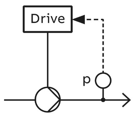

Adding a PLC
The VFD must have some information about the process to control the speed of the pump. This should come from a sensor or an application controller like a programmable logic controller (PLC). When the sensor is connected to the VFD, known as closed-loop control, the sensor closes the loop by sending information on a single parameter back to the drive. This information is compared to the setpoint. The setpoint is the target for control, and the speed will change if there is a deviation between the feedback value and the setpoint.
A PLC would be used in applications where multiple factors are utilized for control. A set speed reference would be sent to the VFD, increasing or decreasing the speed accordingly. A modern VFD can interface to a wide range of sensors such as pressure, flow, temperature, level, humidity, etc. The most common signals from sensors are still analogue 4-20 milliamps (mA) and 0-10 volts direct current (VDC).
IMAGE 2: Constant pressure control with pump/VFD and sensor (p)
