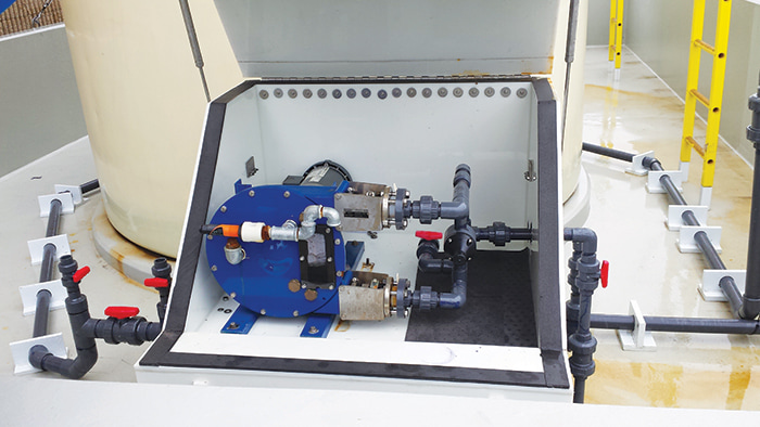

Peristaltic pumps are ideal for various chemical-handling applications in wastewater treatmentImage 1. Peristaltic pumps are ideal for various chemical-handling applications in wastewater treatment because their simplistic design and operation allow them to reliably handle both viscous and abrasive chemicals. (Images courtesy of Neptune Chemical Pump, part of PSG, a Dover Company)

This pump technology, simplistic in its design, is well-suited for handling viscous and abrasive chemicals. Because the design features a rotor with shoes or rollers that squeeze the hose or tube and force the liquid to the discharge port, peristaltic pumps are able to run dry—a feature that technologies like some progressive cavity pumps cannot provide because their rotors and stators may be damaged in dry-run conditions.
Peristaltic pumps also do not have valves that can become clogged. This is an important consideration when the pump needs to be shut down during a product run. The lack of valves in a peristaltic pump eliminates any clogging issues, especially when handling viscous liquids or those that will solidify or become gelatinous when resting. This also makes the peristaltic pump ideal for handling abrasive or corrosive chemicals.
