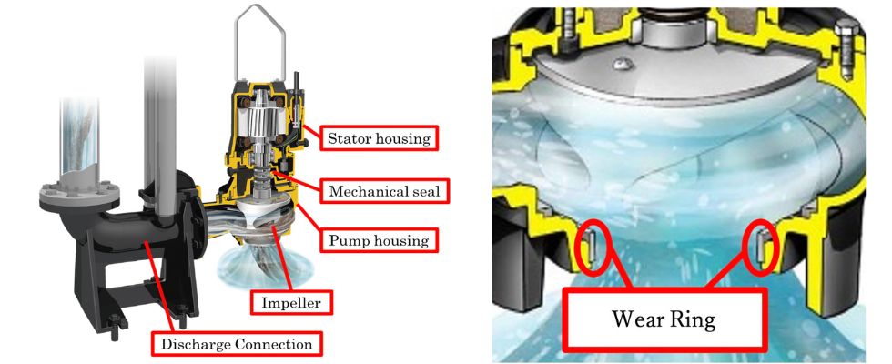

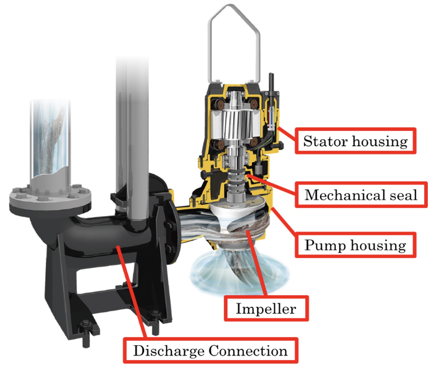

This article will focus on the single-vane non-clog impeller, which is designed for passing debris. This impeller causes hardly any clogging at all due to its single flow path (Image 2). Image 1 shows the structure of a typical pump. Very little wastewater enters the motor chamber because the mechanical seal ring works together with the shaft while maintaining proper clearance. This is a standard sealing part for submersible pumps with high-speed rotary impellers. The contact surfaces wear out, so regular maintenance is required, but it is an excellent mechanical element. The motor chamber is designed to properly seal out wastewater. Parts such as the pump housing and impeller are important, as they are directly related to pump performance. In particular, the impeller is the key technical component. Impellers can be vortex, single-vane, double-vane, axial-flow or mixed-flow. Many manufacturers have cutter, chopper or grinder pumps, which have a suction plate to crush or cut debris. The suction plate blade is a consumable that needs to be replaced periodically.

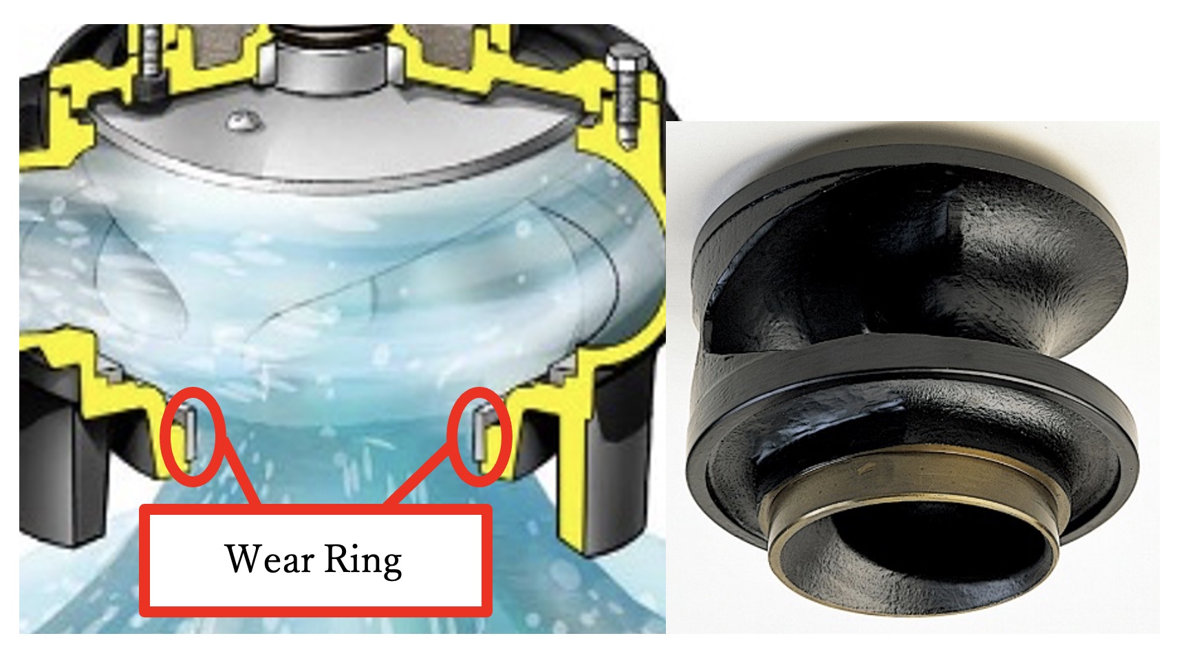

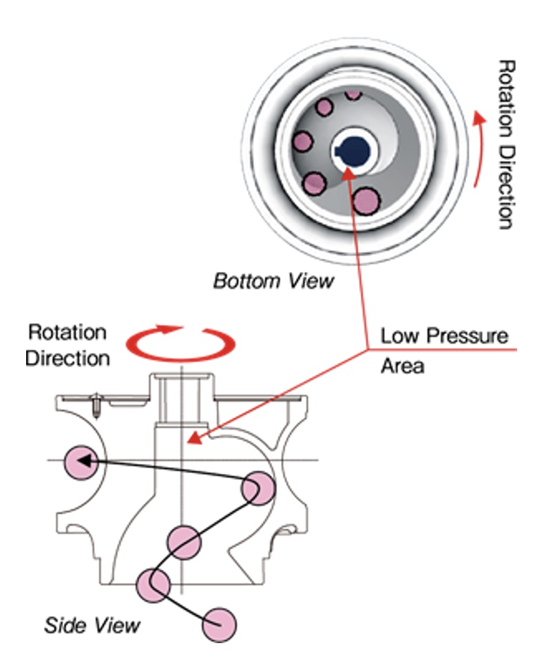

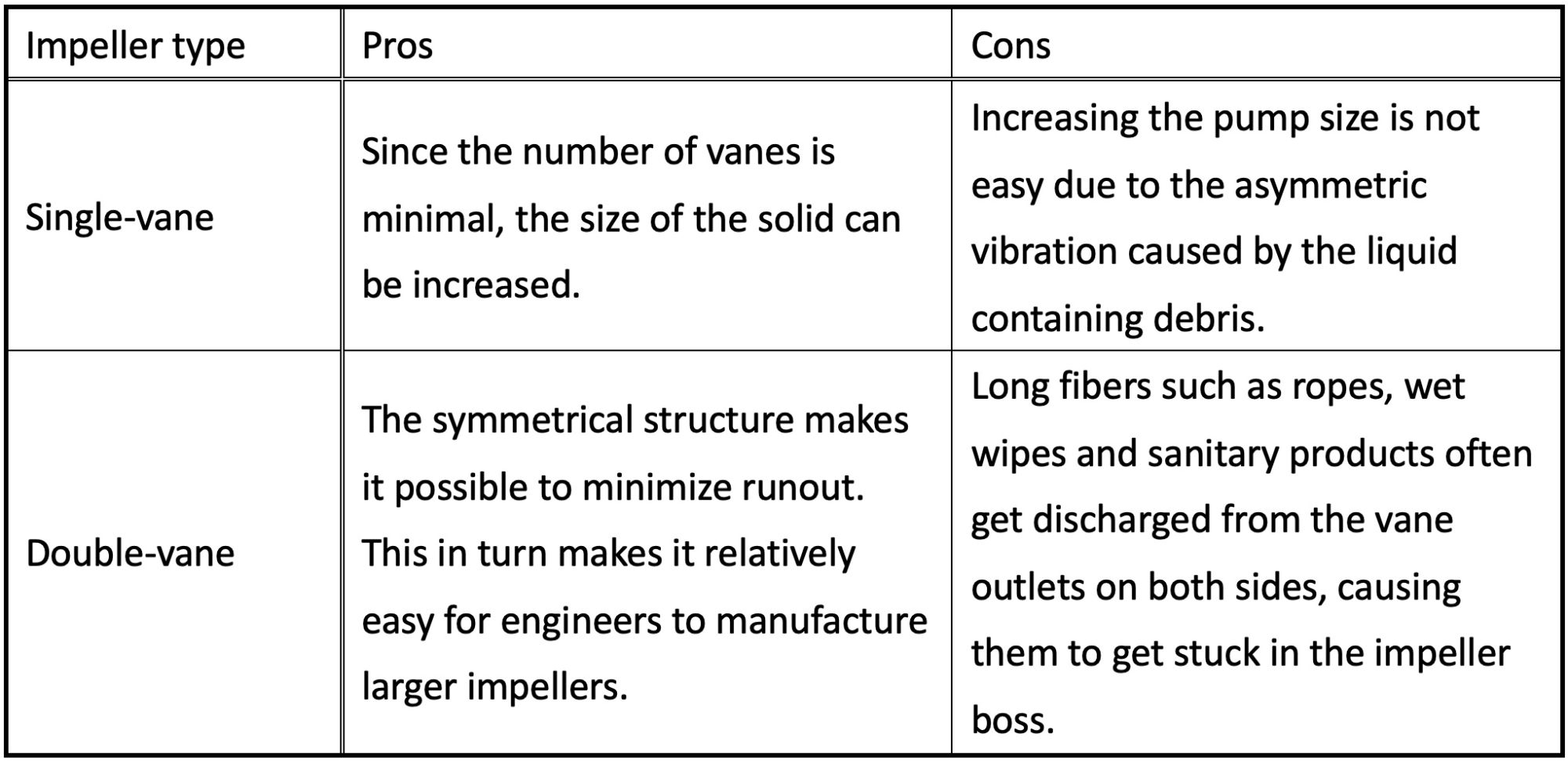

Image 2 shows a single-vane non-clog impeller and wear ring. This impeller features high throughput and high hydraulic efficiency. The cross-section in Image 3 shows how the impeller consists of a single vane. The suction port has a spiral shape, so debris passes through it and exits from the discharge port. How do single-vane and double-vane impellers compare? There are many types of double-vane impellers that are used frequently in the pump industry. Table 1 lists the pros and cons of the two options.
Table 1: Single-vane vs. double-vane impellers

  2. Does debris accumulate in the low-pressure area of the ​​impeller boss?

  1. Due to the insertion of the wear ring, the gap between the pump housing and the impeller is extremely small, and the main solids entering the LS—such as empty cans, plastic bottles, ropes, sanitary products and wet wipes—cannot pass through this gap. The structure also prevents fine debris such as hair and sand from accumulating on the back side of the impeller.
  2. The unique shape of the impeller prevents spiral flow from stagnating. The core consists of technology that passes debris without leaving it on the impeller boss. This flow is created by a single vane—no other vanes are involved.

The wear ring is a consumable, but it can easily be replaced by flipping the pump housing over and replacing it using a flathead screwdriver and hammer. The vertical mounting design allows for easier and more efficient inspection and replacement of parts. The pump unit can be detached without removing the impeller from the motor. Together, these features reduce the workload of maintenance contractors significantly and support stable site operation.
