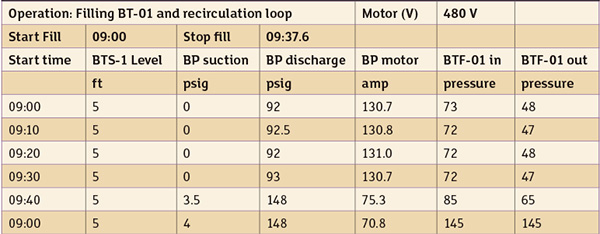

Table 1. The operating data collected during the assessment when filling BT-04 and the minimum flow recirculation (updated—see Author’s Note)
Table 2. The operating data collected during the assessment when filling BT-01 and the minimum flow recirculation (updated—see Author’s Note)Pumping Elements

Using the operating data collected during the system assessment for filling Batch Tank 4 (Table 1) and Equation 1, one can determine the power requirement for the batch pump (see Equation 3).
The pump flow rate (Q) can be determined using the time required to fill Batch Tank 4. Because filling the 60,000-gallon batch tank took 40 minutes and 36 seconds (40.6 minutes), the calculated flow rate through the pump is 1,477 gpm.
The pump head is calculated by measuring the differential pressure across the batch transfer pump. The average differential pressure using the supplied data is 101.6 pounds per square inch differential (psid). With a fluid density of 62.4 lb/ft3, the total pump head is 234.8 ft.
The pump and motor efficiency can also be determined. The pump efficiency is taken from the manufacturer’s pump curve. Given the pump’s impeller diameter (17.5 inches) and calculated flow rate (1,477 gpm) the pump’s efficiency from the pump curve is 76 percent. The motor efficiency of 94 percent was found on the motor nameplate.
The power supplied to the electric motor can be calculated using the motor voltage, current, efficiency and power factor (see Equation 2).
The power factor listed on the motor nameplate is 0.85. Based on the current and voltage readings from Table 1 for filling Batch Tank 4, the motor power consumption is calculated using Equation 4.
The similarity between the values calculated for electrical power consumed using pump data (Equation 1) and the electrical power consumed using motor data (Equation 2) shows the close correlation between the two methods.
Using the operating data along with the pump and motor energy calculations, a table that shows the power consumed by the pump during the two fill modes and two bypass modes can be developed (see Table 3).
