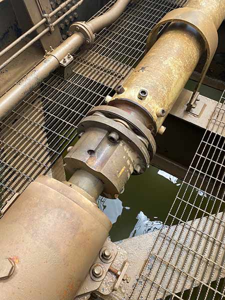

IMAGE 1: Coupling selection for dredge application (Image courtesy of PSC Couplings)

After the style of dredge and pump are determined, the driveline can be selected. If the dredge is in-hull, there are several options: use a direct drive through a gearbox; use a marine transmission; or use a belt drive. If the dredge is a ladder design with the pump on the ladder, the driveline design will require torque tubes with couplings on either end of the tubes supported by bearings, all suitable for underwater usage.
Ladder Dredge: Driveline Considerations for the Dredge Pump
The driveline allows mechanical power to be transferred from the engine or motor to the dredge pump. During operation, the driveline faces a harsh environment just like the dredge pump. The driveline needs to operate under conditions with periodic shock loading, dynamically changing misalignment, and a sandy, abrasive underwater environment. In addition to operating reliably in a harsh environment, the installation of the driveline needs to be efficient and cost effective.
Coupling Selection for the Driveline
Disc couplings are the primary couplings chosen for driving a dredge pump on a ladder dredge. The nonlubricated design of the disc coupling does not require any special sealing. In addition, the use of corrosion-resistant materials and coatings is relatively economical. The following are several areas considered when selecting a disc coupling to drive a dredge pump on a ladder dredge.
1. Torque density
The torque density of the disc coupling is an important factor to consider. The most common definition of torque density is the continuous torque rating of the coupling divided by the mass of the coupling. The higher the torque density, the lower the coupling mass for a given torque. With higher torque density and resulting lower mass, the coupling causes less of a bending moment on the driveline. This reduces vibration levels and can increase the life of bearings and seals. Torque density is critical to ensuring the driveline has a long, useful life and the uptime of the dredging vessel is maximized.
2. Durability
The disc coupling must be able to handle the shock loading and vibratory torque the driveline will experience. At the same time, the coupling must be able to handle the dynamic misalignment of the driveline during operation. The disc coupling must do this while operating underwater, so proper materials and corrosion-resistant coatings must be selected. The disc coupling also needs to be sized appropriately. The torque rating of the disc coupling along with the appropriate service factor are important when selecting a coupling size.
3. Ease of installation & ease of service
Ease of installation and service of the disc couplings are also critical aspects to consider. The first consideration is how the disc couplings will be integrated into the torque tubes. The disc couplings will either be welded to the tubes or attached to the tubes with fasteners. Fasteners offer several advantages over welding during initial installation. These advantages include improved driveline quality with less material deformation due to heat and less installation time. Also, a coupling installed with fasteners is significantly easier to manage in the field if the driveline ever needs to be serviced. It is preferred to use standard fasteners in these applications since standard fasteners are readily available and relatively inexpensive.
4. Cost factors
Cost is an important factor when making the driveline design and disc coupling selections. The opportunities to improve costs can be seen in several areas such as initial coupling cost, installation time, driveline quality and field maintenance of the driveline.
