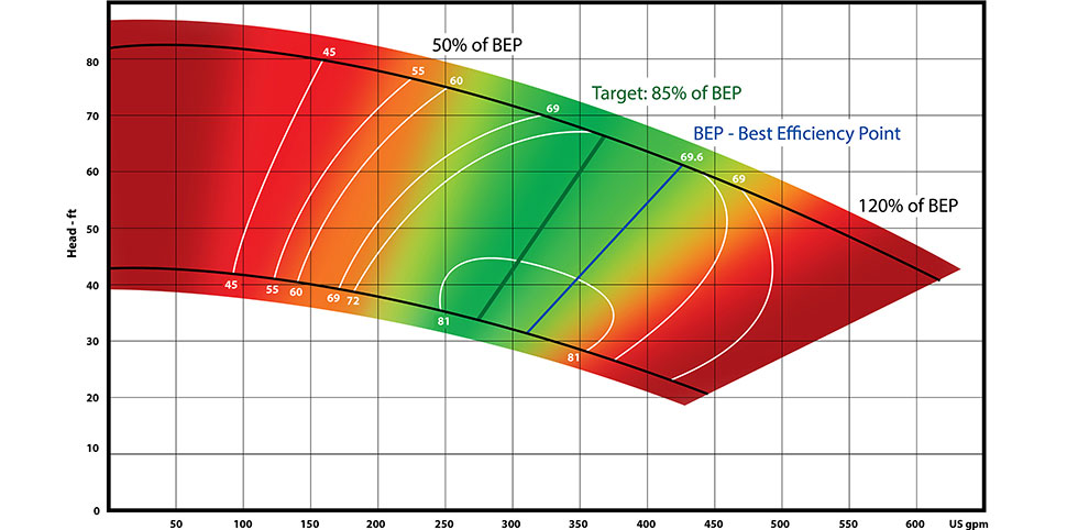

Therefore, it may be best to target selections at around 85% of BEP. This allows system fluctuations of 35% to the right and left of BEP, without moving out of the acceptable 50% to 120% window.
In Image 3, the optimal range of operation on the pump curve is shown. The area in green encompasses that 50% to 120% window, with pump operation becoming more unstable as you move out into the red on either end of the  curve. Note the short distance past BEP before the pump would enter nonoptimal and potentially problematic operation.
Recommended operating zone on a pump curve relative to BEP
IMAGE 3: Recommended operating zone on a pump curve relative to BEP
