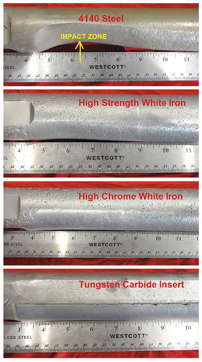

In some applications, such as dredging a new channel or in the “hydrotransport” of phosphate matrix and oil sands, the largest solids can exceed 100 millimeters (mm), or 4 inches, in diameter. At this size, impact wear at the impeller inlet and casing cutwater will often limit service life. While several tests exist for quantifying slurry wear resistance, they invariably use sand-sized particles, so little is known about the impact resistance of typical slurry pump materials under more extreme loads. Because many such materials are relatively hard and brittle, this issue cannot be overlooked. Key questions include:- Do the relative rankings of materials change as the impact becomes more severe?
- Is there a limit of strength or toughness that must be maintained?
- Does the third power relationship between impact velocity and wear still hold true?

Image 4. Comparison of various impact wear samplesSlurry Testing
