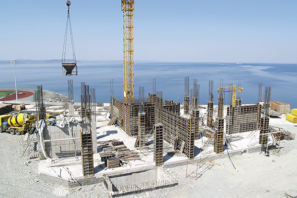

When dealing with a construction site that is underwater or where the water table is just above sea level, contractors must ensure that the excavation stays dry and safe for workers. This can be even more challenging in locations with conditions affected by water depth and complications like silt and sand. Additionally, these difficult conditions may vary during seasonal weather or with the tides. Contractors need to investigate historical data and monitor fluctuations in water levels and speeds of flow to decrease the risks for workers and ensure the success of the project. The contractor must decide what pumping equipment to use based on the hydraulic conditions. Jobsite conditions—such as flow required to mitigate water seepage, depth of a coffer dam and solids content—influence this decision. The contractor usually chooses between self-priming centrifugal pumps or submersible pumps.
