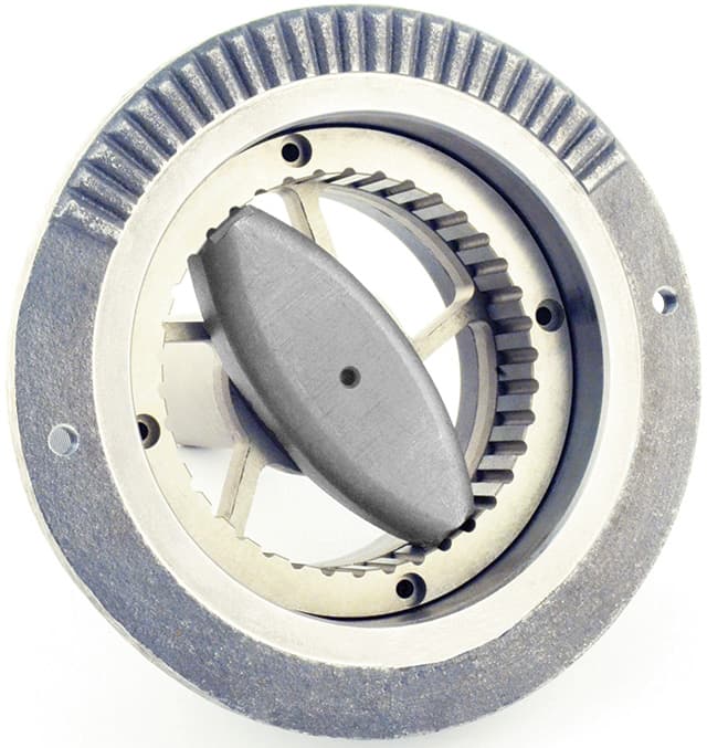

Several pump companies have attacked the problem by developing equipment that will shred wipes and other solids to make them safe for wastewater systems. The engineers at one company have developed dual shredding technology that features radial and axial shredding elements. This design obliterates wipes and other hard-to-handle solids. "Incorporating both radial shredding and axial cutting achieves optimum results on hard, to near impossible to pump liquids containing fibrous solids like wet wipes," said Brian Mitsch, the company's VP of operations and engineering. "The radial shredding is achieved by a rotating cutter bar with serrated edges, which traps and shreds solids against the sharp grooves of the radial cutting ring. Wipes and other fibrous debris are efficiently ripped apart. The complementary axial cutting utilizes dual cutting elements operating in tandem to multiply the shearing action. As the material exits the radial shredding area, the axial cutting components shear any remaining pieces using multiple cutting bars. The impeller design expedites flow and hydraulic performance, preventing wrapping and clogging." These pumps feature shredding elements that are cast in hardened 440C stainless steel (Rockwell hardness above 55C), and the patent-pending design provides excellent solids-passage efficiency through its impeller and volute. Available with 2-, 3- or 5-horsepower (HP) high-torque four-pole motors, these pumps are ideal for smaller wastewater stations..jpg)
