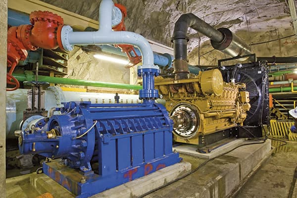

12-stage pump coupled to a 1,250 kilowatt turbo-charged diesel engineA 12-stage pump coupled to a 1,250 kilowatt turbo-charged diesel engine
The hydraulic designs and materials of clear-water pumps would not last long when faced with any significant solids content. Therefore, dewatering pumps combine some features from clear liquid and solids handling designs to ensure that reliable performance levels can be achieved. A key part of this is that the materials of construction for the parts contacting the product must provide erosion and corrosion resistance. If the solids content rises above the levels mentioned for prolonged periods of time, then conventional slurry pumps will usually be required. Mining-duty pumps are available that cover clear-water to high-solids content. These can be mounted on trailers, skids or barges and can be driven by either electric motors or diesel engines.
