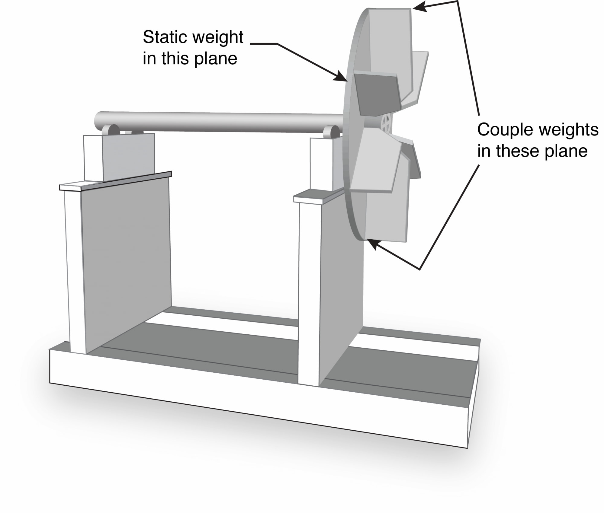

Static-couple  technique for overhung rotors in the balancing machine (Images courtesy of EASA)
IMAGE 1: Static-couple technique for overhung rotors in the balancing machine (Images courtesy of EASA)
Single-Plane vs. Two-Plane Balance
The next decision is whether to use a single-plane or two-plane balance. An old guideline not shown in the current ISO standard 21940-11 said single-plane balancing was acceptable for rotors with a length-to-diameter ratio less than 0.5 and rotating speed below 1,000 rotations per minute (rpm). Although most pumps operate above 1,000 rpm, many pump manufacturers only balance impellers in a single plane. That is fine if they control the manufacturing process to minimize “couple imbalance” but numerous instances show this is not always the case. Once the impeller is in the balancing machine, checking the balance in two planes is recommended (Image 1).

Balance corrections on pump impellers entail removing weight, usually by grinding on the impeller shrouds and then smoothing the affected areas. Drilling holes to remove weight is discouraged because the holes will generate localized turbulence in the pumpage.
Since it is difficult to “ungrind” a correction weight, make the initial correction by attaching putty to the impeller. When acceptable balance is achieved, grind the correction weights 180 degrees from the putty location. If the initial balancing with putty calls for a large amount of correction weight in a couple configuration, evaluate whether two-plane balancing will be practical.
Large couple imbalance usually results from casting and machining anomalies in the manufacturing process. Again, manufacturers try to control these anomalies, so they only balance impellers in a single plane. When it is impractical to correct a couple imbalance on an impeller, the impeller is often “bad” and needs replacement. It is recommended to balance the pump impellers to G2.5 per ISO standard 21940-11. Special balancing procedures apply to high energy pumps as defined by the American National Standards Institute (ANSI)/Hydraulic Institute (HI) Pump Standards.
