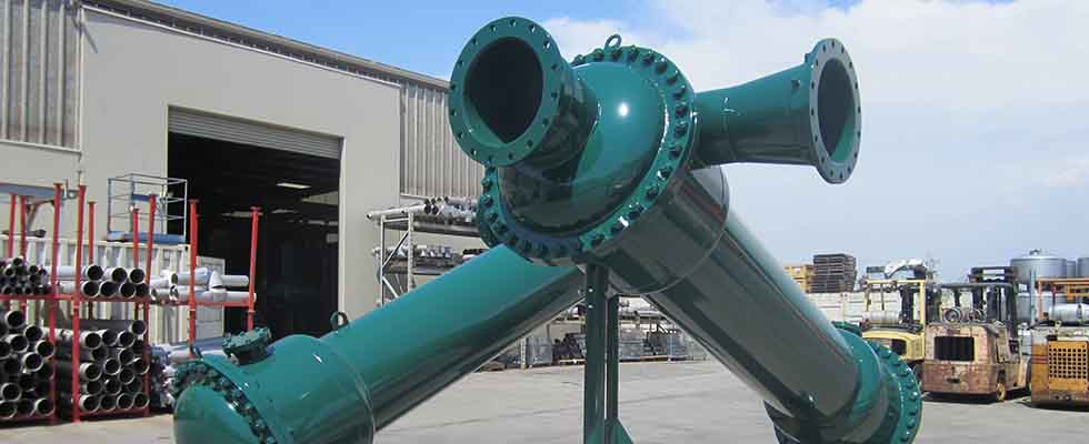

Centrifugal sand separators use simple physical principles to remove heavier-than-water particles from a fluid stream. Unlike filters that trap particles in a media or screen, centrifugal separators exploit differences in particle density. A separator can be installed as a side-stream loop, in which a small portion of the recirculating water is diverted through the separator and returned to the basin. It can be installed as a basin sweep system to concentrate on the part of the tower where solids typically accumulate; it can be installed upstream of the suction pump to prevent sand and grit from entering the pump; or it can be installed in multiple places, depending on goals and budget. In general, centrifugal sand separators are quite easy to install.
Here is how the process works:
  1. Water entry: Contaminated cooling tower water enters the separator and is accelerated, creating a rapidly spinning vortex inside the separation chamber.
  2. Centrifugal action: As the water spins, centrifugal force drives heavier particles toward the outer wall of the chamber.
  3. Particle separation: The solids lose momentum and migrate downward into a collection or purge chamber at the bottom of the separator.
  4. Clean water discharge: The cleaned water, now free of most heavy particles, spirals upward through the vortex and exits through the separator’s outlet, continuing on to downstream equipment.
  5. Solids purge: Accumulated solids in the collection chamber can be removed manually or automatically, depending on the system design.
Because there are no moving parts, screens or replaceable media, centrifugal separators are usually highly reliable and require minimal maintenance. The separation efficiency depends on particle size, density and flow rate, with the greatest effectiveness being achieved for particles larger than 75 microns.
