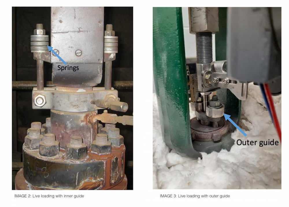

One style of live loading uses springs and an inner guide (Image 2). Another type uses springs and an outer guide (Image 3). The outer guide acts as a load indicator that helps remove reliance on torque for proper installation. These cartridge-style sets are designed for a specific load; inaccuracies with measuring torque are eliminated with the cartridge because they are designed so the correct load aligns the top washer flush with the top of the cartridge. This visual guide allows for better performance of the assemblies.
IMAGE 2: Live loading with inner guide and IMAGE 2: Live loading with inner guide and Image 3: Live loading with outer guide

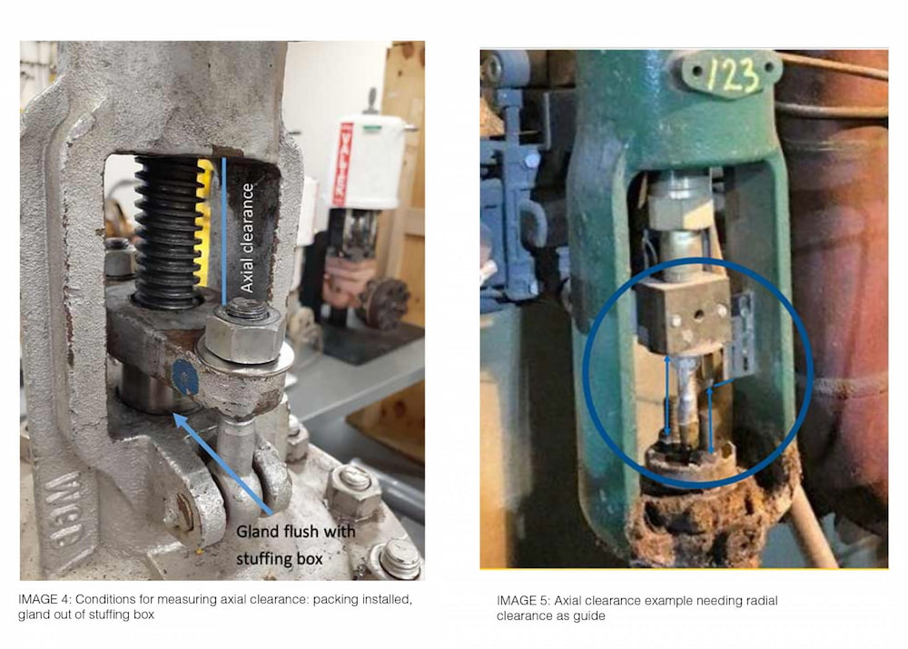

Measuring radial and axial clearances are key for successful installation of live load assemblies. For radial clearance, measure from the center of the bolt to the nearest obstruction around the bolt. This will be valve-dependent but is likely the valve stem. When measuring axial clearance, measure from the top of the gland nut to the nearest obstruction above the bolt. This measurement should be taken when packing is installed but representing a “worst-case scenario” where the gland is fully out of the stuffing box (Image 4). Be sure to remember to evaluate based on radial clearance as there may be an obstruction from the radial clearance that will affect axial clearance. See Image 5 as an example where the back bolt gives more clearance than the front. The shorter distance should be taken as the allowable clearance. It is important to double-check that all clearance measurements are valid for fully open positions, fully closed positions and every position in between.
IMAGE 4: Conditions for measuring axial clearance: packing installed, gland out of stuffing box and IMAGE 5: Axial clearance example needing radial clearance as guide
