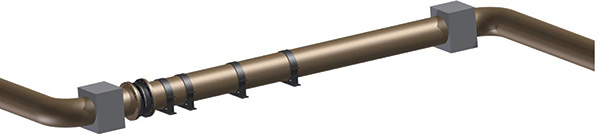

A typical expansion joint (Article images courtesy of FSA.)Section-by-Section System Optimization
The expansion joint selection and application process often requires a systematic and sometimes tedious approach. First, the proposed piping should be divided into individual sections (straight runs or L- or Z-shaped bends) by choosing tentative anchor locations. Each section can then be optimized and later rejoined with the complete piping system, resulting in a completely optimized, efficient system. This process will require additional consideration for the following:- Capabilities and limitations of different anchor types, including main, directional or intermediate
