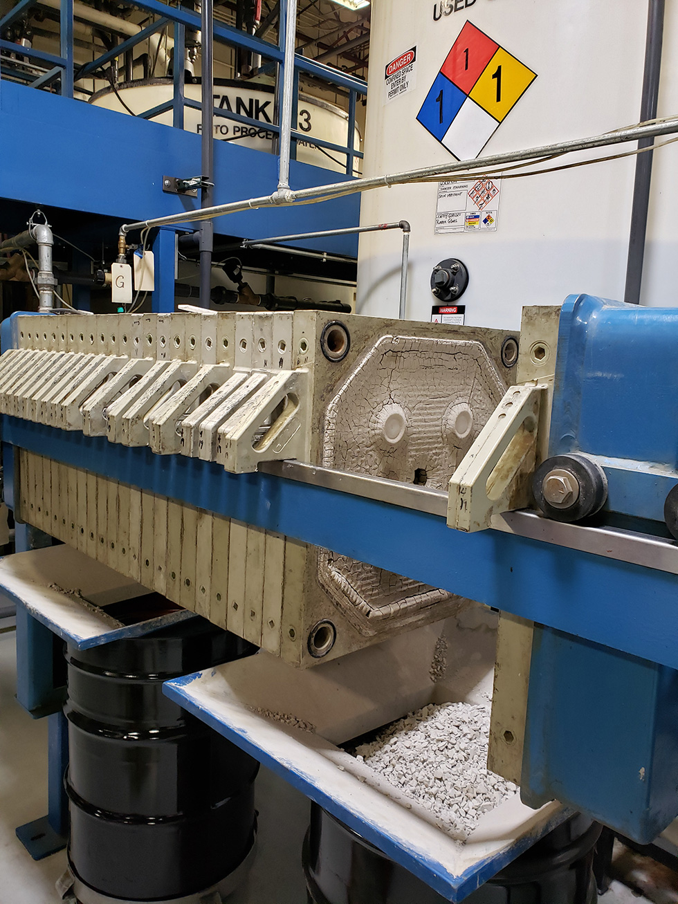

A filter press separates solids from various types of waste fluids and by-products created in a variety of industrial applications—typically in food, chemical, mining, edible oils, pigments and dyes and pharmaceutical industries.
The fluids processed through a filter press are often viscous sludge or slurries. They can be abrasive and chemically aggressive in nature.
Once processed, the trapped solids, referred to as a “cake," remain in the filter press. The cake can be reused in some processes or sold off for further processing.
In many applications, the major advantage of the filter press process is that it minimizes the disposal costs tied to wet slurry. Because disposal costs are commonly based on the resulting cake weight, filter press operators strive to eliminate as much moisture as possible.

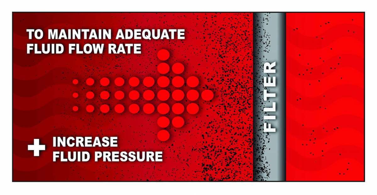

How Does a Filter Press Work?
Fluid is pumped through a filter press that contains a series of filters to trap particles. As fluid passes through the press, the flow gets more and more constricted. Meanwhile, solids collect on the surface of the filters.
Because the filter continues to trap solids over time, the fluid pressure must be gradually increased to maintain adequate filtration flow rates.
As a result, the pump processing the fluid must be stopped periodically so the filters can be cleaned.

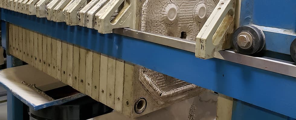

Because filter press applications often involve corrosive or chemically aggressive fluids, safety and reliability are of the upmost importance.
filter press
The abrasive nature of certain fluids can lead to downtime; so, it is important to select the right materials to ensure all system components are suitable for the application.
