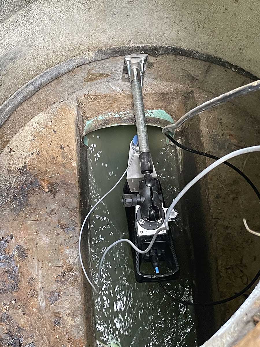

Wide Diameter Urban Sewer Pipe
While municipal sewer pipes typically fall into the 12-inch diameter range, interceptor pipes for large urban districts can reach up to 10 meters (33 feet) wide. In these scenarios, the volume and velocity of water can reach staggering levels, especially during a rain event. A submersible flow meter is a poor fit for this job, simply due to the risk and difficulty of installing and maintaining flow meters under deep, swiftly moving water with highly complex contents.
The ideal flow meter in this situation is a noncontact area/velocity flow meter that calculates flow from above the water surface with high accuracy. The device works by first sending radar pulses to detect the speed of the water’s surface by “reading” ripples and waves, then measuring depth using a level sensor. Using the area-velocity method (speed x cross-sectional area), the device calculates flow, with all processing taking place inside the sensor and without external equipment. Flow data is sent directly to a supervisory control and data acquisition (SCADA) system or to other monitoring systems.
As this kind of sensor is installed above the surface of the water, installation and maintenance are accomplished without entering the water. When conditions may be especially hazardous for workers, this is the sensor for the job.
