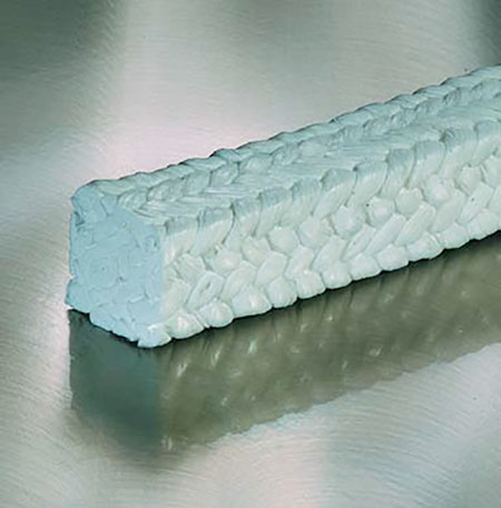

IMAGE 2: Braided packing made of PTFE yarn

These characteristics of PTFE are advantages in sealing. Specifically, as a braided packing, thin filaments of PTFE yarn are braided into a lattice structure, cut into rings and are compressed into a stuffing box. Due to PTFE’s low coefficient of friction, the packing is used with or without a lubricant. The lubricant, made of white paraffin mineral oil, is a mixture of liquid hydrocarbons. Paraffinic and naphthenic in nature (obtained from petroleum) meets FDA and NSF registration guidelines. However, some end users prefer PTFE dry to eliminate any risk of contamination with their process fluid.
