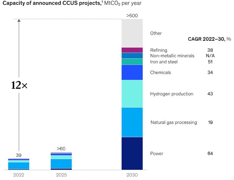

IMAGE 1: Significant growth in planned CCUS projects, reflecting rising investment in CO2 infrastructure. Source: McKinsey Energy Solutions, Global Energy Perspective 2023.

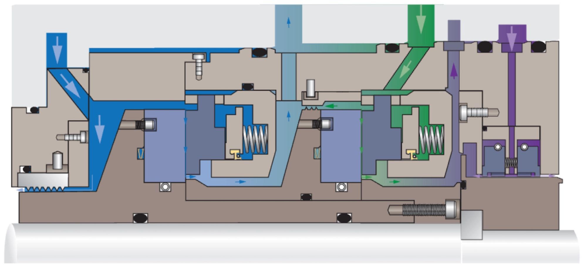

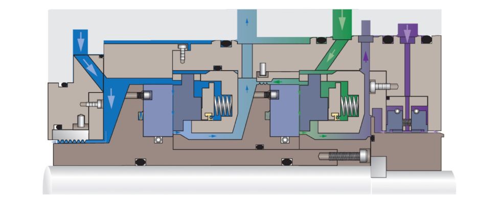

IMAGE 2: Tandem dry gas seal featuring interstage and process labyrinths with a separation seal for redundancy and secure containment (Images courtesy of Flowserve)

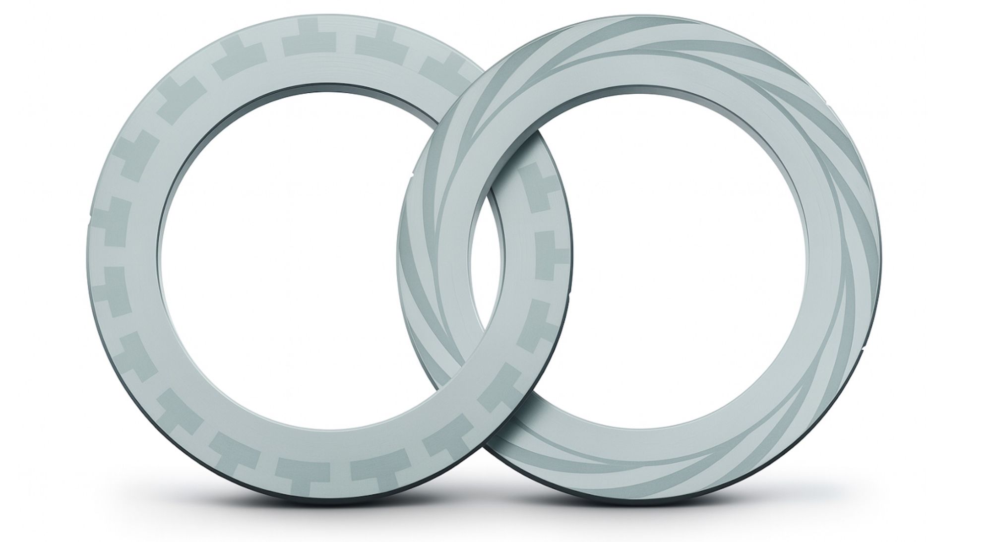

IMAGE 3: Seal face patterns designed for gas-lubricated dry gas seals. The left face features a lift-generating groove pattern, while the right face shows a spiral groove configuration to optimize gas film stability and minimize leakage.

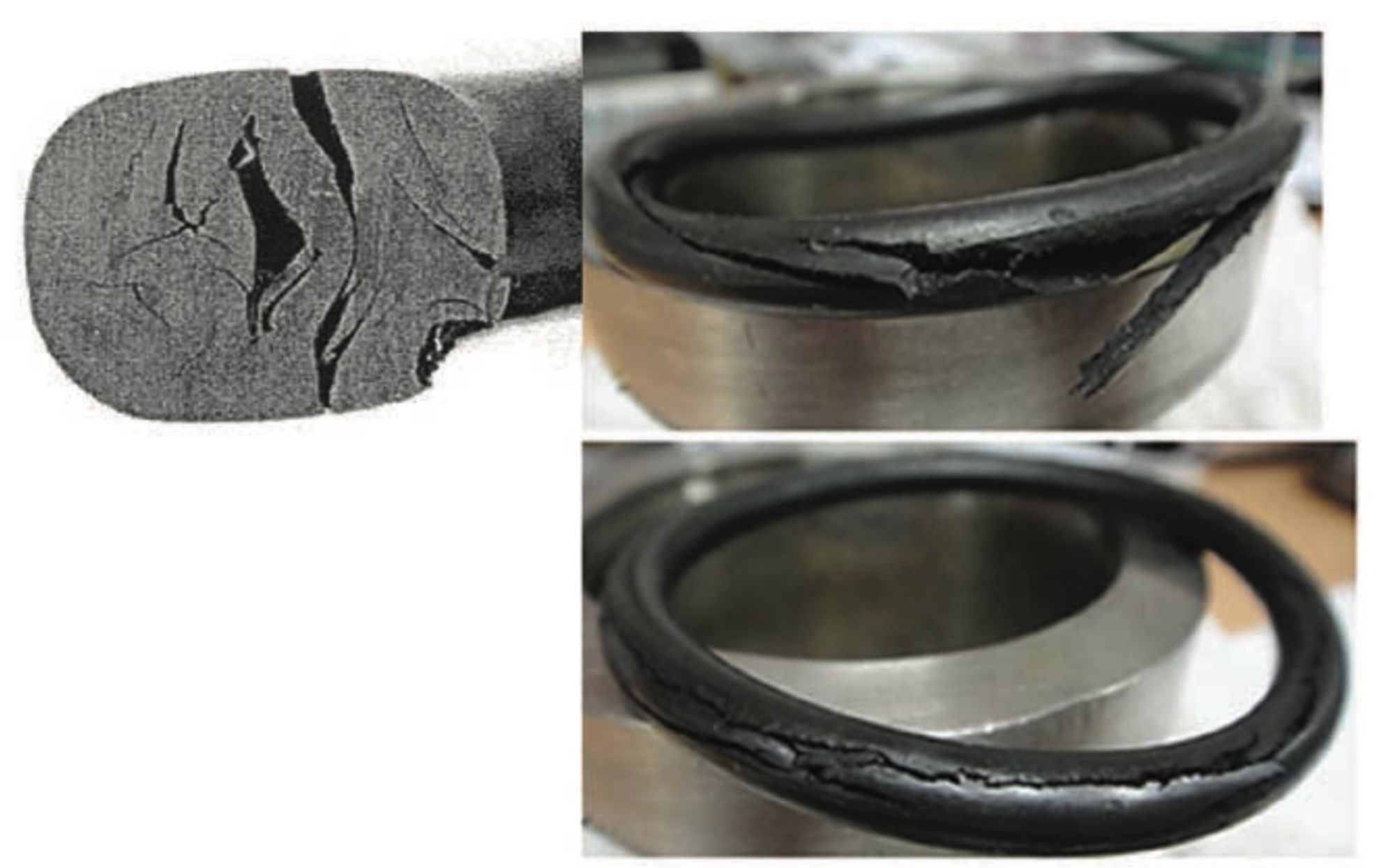

IMAGE 4: Typical rapid gas decompression (RGD) damage on elastomer O-rings used in turbomachinery applications. Source: Carmody & Kaminske, Sealing Technology, Vol. 2015, Issue 12, pp. 8-12.
