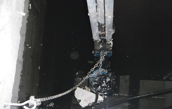

Three grinder pump models were selected for the project. A total of 68 grinder pumps were installed in 34 sewage pits. The pump models differ in horsepower (HP), from 1.1 and 1.7 to 2.8 HP. The 18 2.8-HP grinder pumps installed on the mall site have a capacity of 80 gallons per minute (gpm). Three solids-handling submersible pumps and two booster sets were also provided. The 4-inch solids-handling pumps have a capacity of 300 gpm.
AFAAQ offered free installation and commission services to the contractor. The sewage pits were mapped and sized for value, and the operation sequence for all duplex sets of submersible pumps was implemented.
In the main sewage tank, a reliable solids-handling pump had to move up to 3 inches of solids without clogging. The selected pump featured breakaway fittings for easy maintenance. The fittings consist of a base elbow and slide rail adapter with brackets. Pumps with breakaway fittings can essentially slide up and down the rails, providing easy installation and removal of solids-handling and sewage ejector pumps in permanent wet-well installations. The pumps do not need to be unbolted, keeping operators out of the lift station.
The pumps also include a cord that allows easy changes of both voltage and cord length without motor entry.
