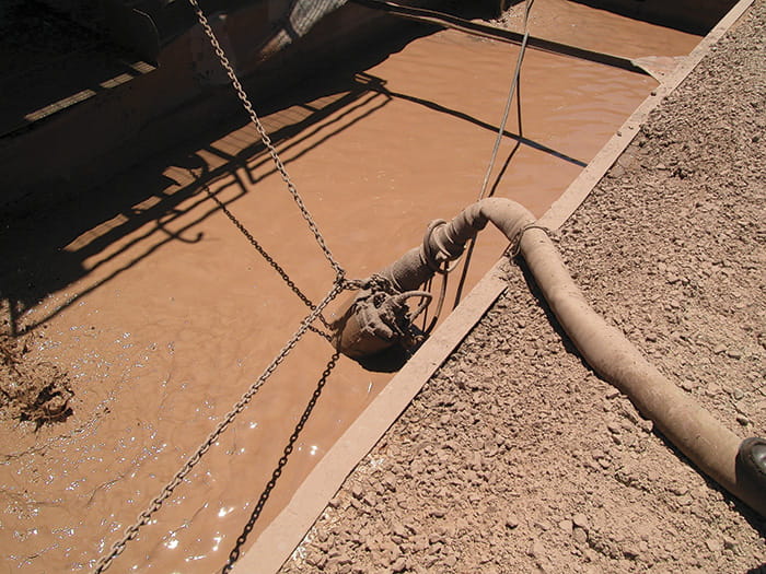

Image 1. Submersible pumps can be designed to prevent them from becoming an ignition source in hazardous environments.Image 1. Submersible pumps can be designed to prevent them from becoming an ignition source in hazardous environments. (Courtesy of BJM Corp.)
