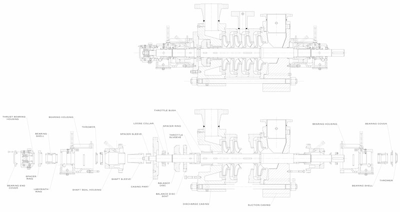

The following multistage boiler feed pump serves as an example (Image 6).
A pump health check is a partial disassembly of a pump to check key wear parts, including bearings, shaft seals, balancing devices and the internal wear ring clearance at the impellers (Image 6). The main casing is not disassembled, and it remains installed on the baseplate with the suction and discharge piping connected but isolated from the system. The pump health check is an inspection of the bearings, seal, balancing device and casing wear rings, as well as alignment verification.
IMAGE 6: Exploded view of a multistage pump
IMAGE 6: Exploded view of a multistage pump (click to view full image)
Bearings inspection:
The first wear part to be removed in the disassembly are the bearings. Important checks for a sleeve bearing include examining the surface condition of the bearing babbitt. Wiping or adhesion is probably the most common problem for a pump sleeve bearing. Minor wear might be repaired at the site, but it is good to have a replacement bearing available to minimize pump downtime. There may also be side loading concentrations due to shaft misalignment with the driver.
Erosion and abrasion due to oil contamination is also possible. Collecting an oil sample and sending it for analysis is recommended. However, for the health check, the visual examination will tell users if they need to install a new bearing.
In addition to inspecting the bearing, be sure the oil supply and return connections are clean and not blocked by debris.
