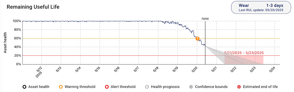

Condition monitoring dashboard showing increasing vibration in a critical effluent pump

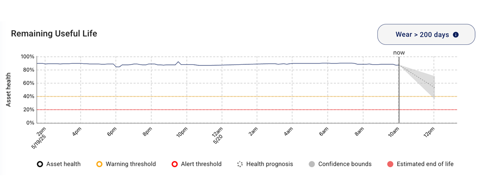

Prognostics take maintenance one step beyond monitoring by predicting when an asset is likely to fail, giving teams time to respond. This is made possible by tracking trends in sensor data (vibration, temperature, pressure, current, etc.) and using models to estimate an asset’s RUL. Image 1 is an example of a RUL chart for an asset where no fault is under development, providing the operator reassurance that the machine is operating as it should.

IMAGE 1: Prognosis chart for a well-functioning asset (Images courtesy of Novity)
IMAGE 2: Condition monitoring dashboard showing increasing vibration in a critical effluent pump

  • Without prognostics: A pump seizes during peak flow. Operators scramble to shut down the process and call in night-shift contractors. An overflow occurs, resulting in a $15,000 fine and local news coverage.
  • With prognostics: Two weeks earlier, trending vibration levels cross a degradation threshold. A work order is generated, and the bearing is replaced during a scheduled maintenance window. Total cost: $2,500. There is no spill, no fine, no incident.
